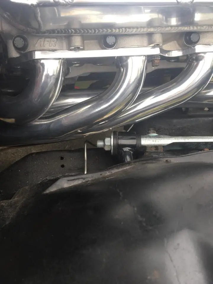

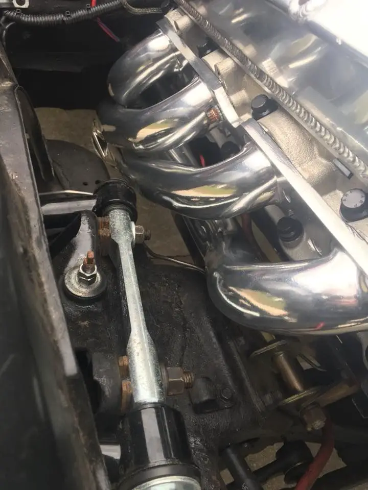

I have finally bled the new system. Tilton master @.700 diameter. And the new pedal effort can be depressed by hand. Excellent throwout bearing movement.
SickSpeedMonte is excellent.
I really wish I could have used his kit. It just won't clear the headers and I'm not about to take a crash course in welding to try to modify the ones I have...

I went back to the old Sanderson Headers part# BB3. Fit like a glove.
I just wish they were 2" primaries, 3.5" collectors and were full length...
I bought the 2241s and ran them for bit. I lost noticeable low end torque and off idle response. I like all my grunt low...all in before 6K.
My build is too mild for them. Only thing I changed was stroke and heads. Cam is the same.
