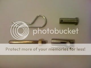

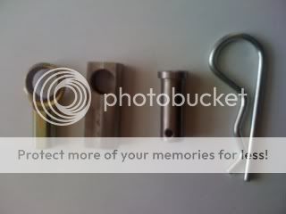

From left to right:
Modified spherical rod end
Custom steel clevis designed by me to accept a 5/16" brake push rod
1.25" long, 1/2" diameter pin (stud)
Retention Pin - a little overkill, but it is easy to remove and install.
The modified spherical rod end I drilled out to 5/8" and installed a bronze bushing on the pin (stud) to take up the slop in the pedal. It worked, but it required spacers/washers also to keep the rod end from moving sideways on the pin (stud).
The custom steel clevis I designed takes out the slop and the side to side play.

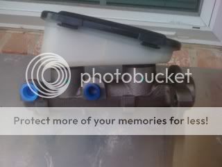

A day after I talk with the rockauto.com representative, I recieve my Wagner 7/8" bore 1978 Chevrolet Malibu manual brake master cylinder in the mail.
See something wrong with this picture? Reservior is on backwards. I will turn it around before i bench bleed it.
Made in the Good Ol' U. S. of A.

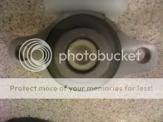

7/8" bore master cylinder piston with the pushrod "dimple"
I pushed in the piston with a brake pedal pushrod I had laying around. Travel was a little over an inch.
