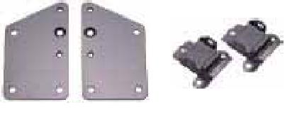

I purchased the TransDapt 4592 LS1 motor mount adapters with rubber mounts. My question is; How the heck do you use these?? Will the factory SBC clamshells bolt to the adapter plate, then just bolt to your existing frame mounts? Do I need to get different frame mounts to bolt the supplied rubber mounts? I'm confused and the instructions are really lacking.....

looks like you use a moroso solid mount on the frame side.

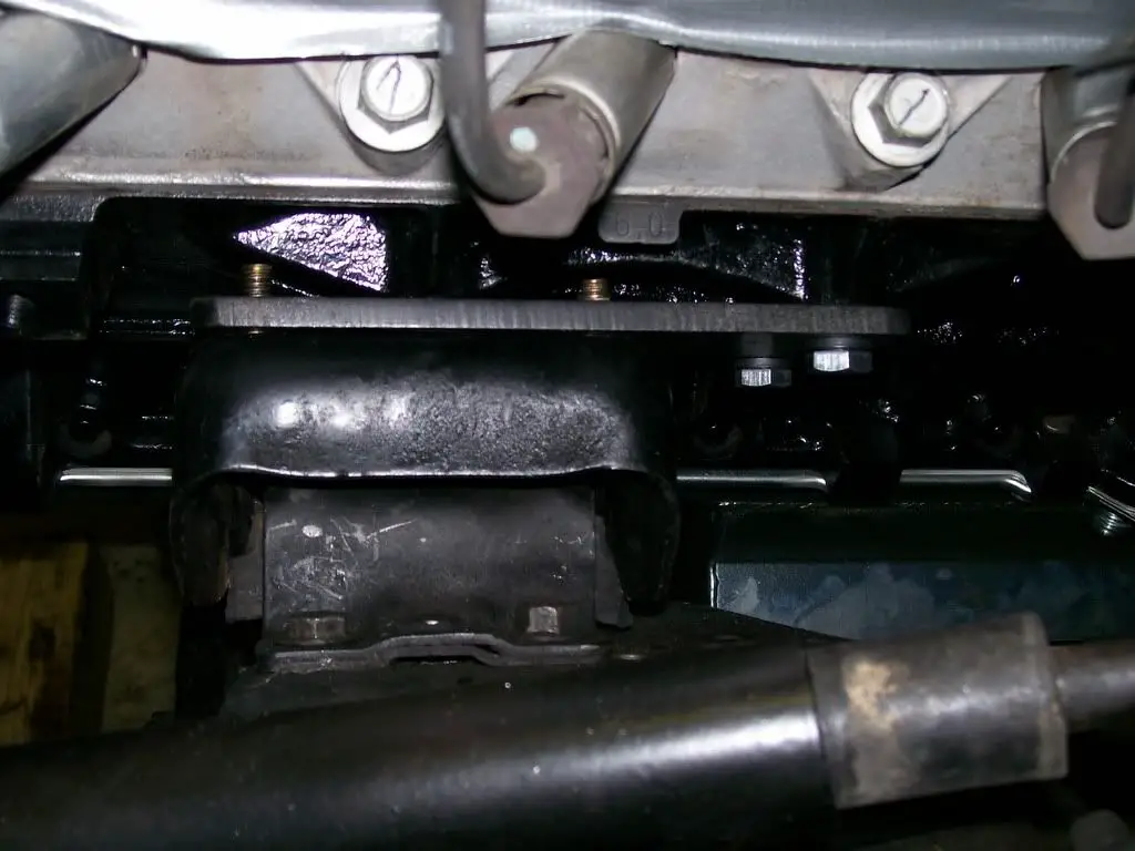

this picture Roller406Bu posted kinda shows how to mount em.....use the countersunk hole and the two on the very far end to bolt to motor and just use the factory clamshell on the factory mounts....

Cool, that's what I was thinking, but I didn't have the motor yet to try it. Supposed to go pick up the motor/transmission tomorrow (Friday). I decided to pick it up to make sure that I get everything I need.
Something I ran into on my 6.0 swap, in this pic the front of the mount that bolts to the motor hits my A/C bracket, and the mount it self moves forward causing the A/C it self to not fit. I'm going to have to use the late model ones that come with the motor. It's going to be a lot more work just to have A/C . Rod
