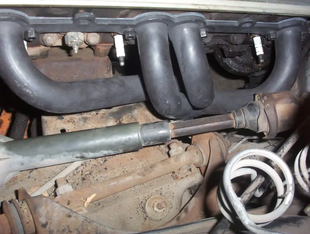

I got a lot done tonight. Im dirty up to my arm pits and I haven't had dinner, but Im much closer to being done. I got the headers on, got my drive shaft in, spark plugs in, and all the belts tensioned. Putting the headers on was a 3 hour job, they were tight! The headers on my big block fit better :lol:

I am glad all is coming together. If the driveshaft was cut properly, it should measure 48.5 inches between the centerlines of the u-joints. This also assumes you have a 7.5-inch differential.

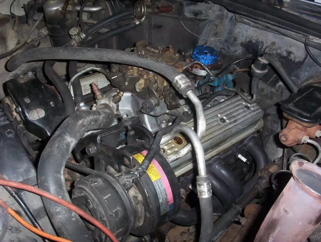

I got my exhaust done tonight, and should be firing it soon. I won't be doing much tomorrow night, CSI is on so I won't be working on the car :lol: I used the stock Y pipe for the most part, and just tied it in to the stock pipe. Eventually I'll be redoing it with 2.5" all the way back, but for now what I have is fine. Here's some pix
