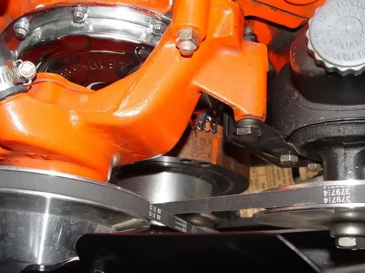

1)Rotate until the pointer is on the amount of advance you want, marking it with marker/paint/etc. will likely help
2)Pull #1 plug and make sure it has enough ground for spark
3)With ignition on, rotate distributor (assuming it's already installed, plug wires on, etc.) until you see spark at the plug. Do this back & forth in smaller and smaller amounts until even the smallest movement fires the plug. Once you're satisfied, tighten the hold down and you're done
It's not 100000% accurate, but if you don't have many tools handy, you're guaranteed an engine that is timed enough to fire and run somewhat acceptable. At the very worst you should be able to drive it until you have access to a timing light... though I consider a timing light one of the crucial tools in hot rod building :roll:
