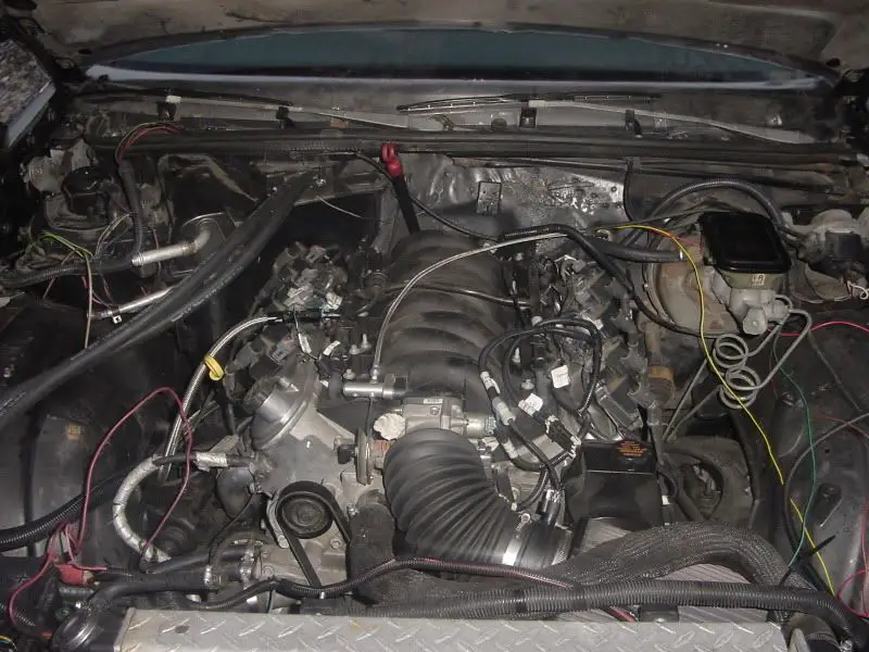

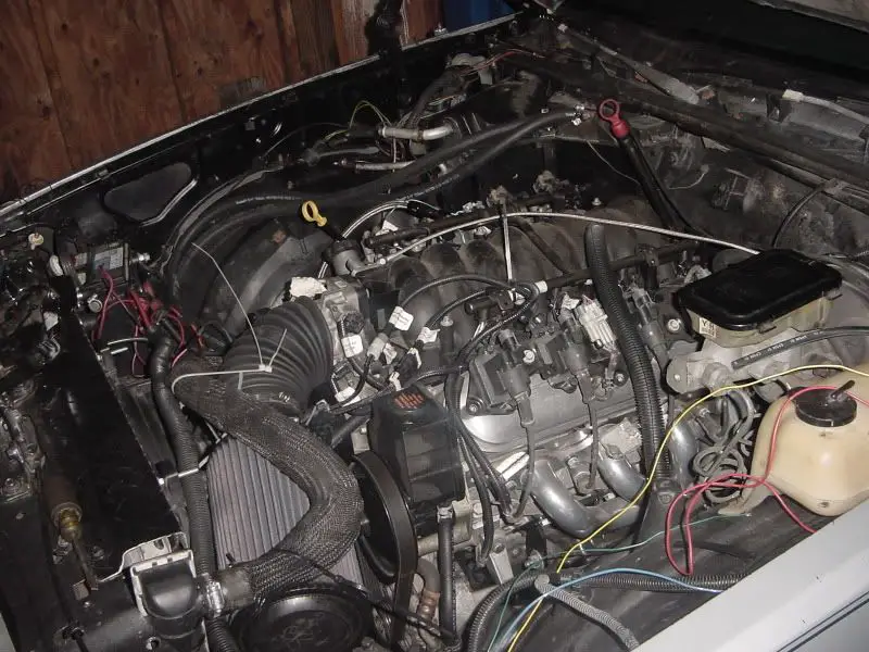

It is running and driving short distances. Got her all together and the 700 was missing the sun gear so we threw the stock(TH250?) in it. Lasted a whole 2 days :lol: . Luckily I got the 700 back the next day. Also got a jegs dual hump x-member for the exhaust, and got the exhaust for christmas. Put the 700 in, worked a detent in, and the lockup is wired to a switch until I get a chance to go back in there and wire it to the 4th gear pressure switch. Interior is still apart, but I want it to go together last so I dont have to take it all apart again for any reason. Anyway, here are some pictures.
Still needs a lot of cleaning up in there, but its stuff I am more capabe and motivated to do while in school.
