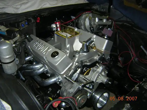

Here's a couple pics I have, I can get closer ones in a few days probably, but the car is at the body shop right now getting a couple little things fixed so it's not here for me to take specific pictures. I didn't have to ding any tubes or anything, although the driver side clamshell mount I had to notch a little bit out of the corner, not too bad but had to do it. I believe with solid mounts the headers would fit with no modifications at all, but I am running poly mounts with the stock clamshells, so I had to make a little notch. I forgot to mention they are equal length tubes and do fit my angle plug heads. Any other questions or anything let me know

Thanks for the pictures. I edited my post before I saw yours! :D
The #1 and #2 tubes look better designed than the Dynatechs, much better for plug wire clearance! If you could get those other measurements at your leisure, that would be great too.
Nice looking powerplant BTW, whats it run?

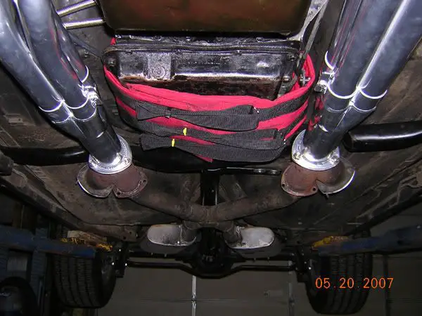

sure man I'll get them for ya tomorrow, sorry I missed the post the past few days didn't mean to blow ya off. My cousin built a Monte SS and he said he tried every different set of headers out there and the Hedman's fit the best. He didn't like the Hookers with the multi-piece design going outside the frame. These fit like a glove besides notching the clamshell. I'll measure for ya tomorrow and post back. It's a lil 383 and it runs 11.70s-11.80s right now with some more to be had, I just need to get it to the track some more, one that is actually prepped and doesn't spin. I'm done with the local track after the way the owner talked to me the last time I was there. Here's a picture underneath that I had.

OK I measured both sides for ya from the control arm mount under the bolt to end of header flange. Driver side was about 21" and passenger side was 25" give or take 1 / 16" on either side. They are long tubes come just about to my crossmember.
