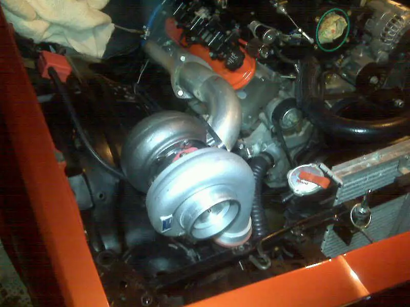

and one more. hey 455-82malibu did you ever get your turbo
siege
Oct 6, 2009
179
dam that is looking good i havnt got a chance to work on mine yet got to get her home before i can start it sucks lol so i am just getting every thing together did your turbo come with the vband flange and clamp
siege
Oct 6, 2009
179
might want to see were buschmec got his his i got raped when i had my down pipe made couse they are off size vband flange the guy told me he had to custum make my flange ??? becouse he couldn't find the right size out this way.
