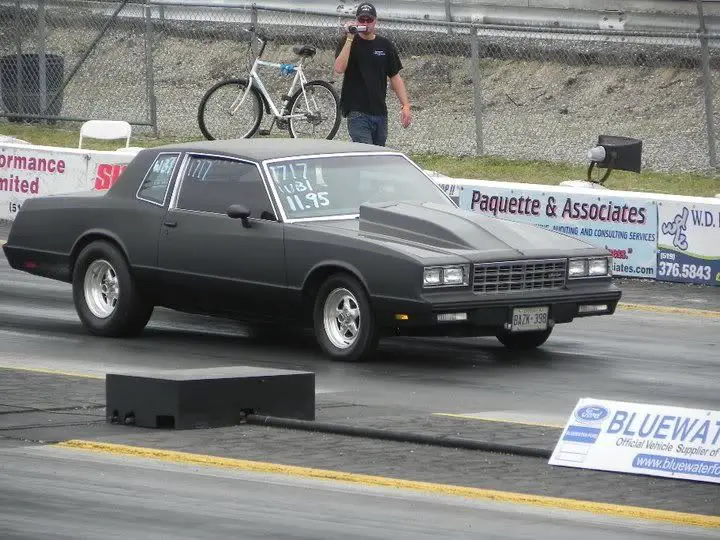

my car with stock V6 springs and iron headed sbc....
my car with trick springs all the way around...

ok griz..this is a big help for me anyway..my car sits similar like yours did..and i have an alum headed.sbc.....i like the look of the trick springs....and how much better does it transfer weight????..i bet alot...what are the 60ft times etc..any improvement?..do you street drive it?..thanks!!

the trick springs helped a little, but not as much as i thought they would. my 60' times didn't change much at all with the switch (maybe 0.02-0.03). the biggest improvement with the trick springs was the change in ride height. i don't drive it on the street anymore, but only because i don't have time...so i don't bother with insuring it for street use.

griz..is your pic with the trick springs?..i like the wheels up..thats my goal!

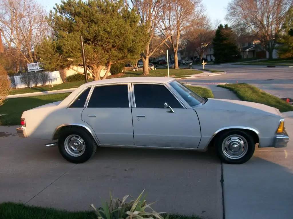

Here's a pic of mine , it has a small block iron headed 355. The car is as it came from the factory. V-6 everything. I love the front but I'm thinking of replacing the front with all new v-6 stuff and redoing the rear in all new V-6 stuff just going to cut a coil or two out. Oh and I do have a airbag on the pass. side.

yea see i like how your front sits ..mine is waaaay high....i think i might try the v-6 springs..maybe a coil cut down some?
