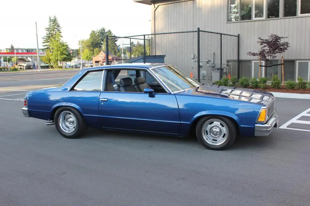

So I did the measurement and mine sits at 6 1/2" from the frame rail to the ground. I think the car needs about another 1/2" to 3/4" lower.
This is how low the car sat in the front before I swapped the new control arms and coil overs. This was with the 2" drop spindles and 1" lowering springs. Too low and not very drivable.

Very nice lookin' Malibu!
OK, so you do have the "Hybrid" Coilover. With that one they only have 10" and 11" springs if I remember correctly.
Sounds like you're on track with the ride height you want. If you haven't already done so, one thing you can try is mounting the shock below the spring pocket on the lower arm i/e the shock t-bar will be bolted up against the bottom of the control arm spring cup, instead of on top of the spring cup. That alone will give you about that much difference because you're essentially dropping the thread range of the shock the thickness of the T bar plus the thickness of the spring cup. I'll measure Blake's Grand National's frame height when I get to the shop tomorrow, he has Speedtech arms and coilovers and we'll see how his compares to our cars.
