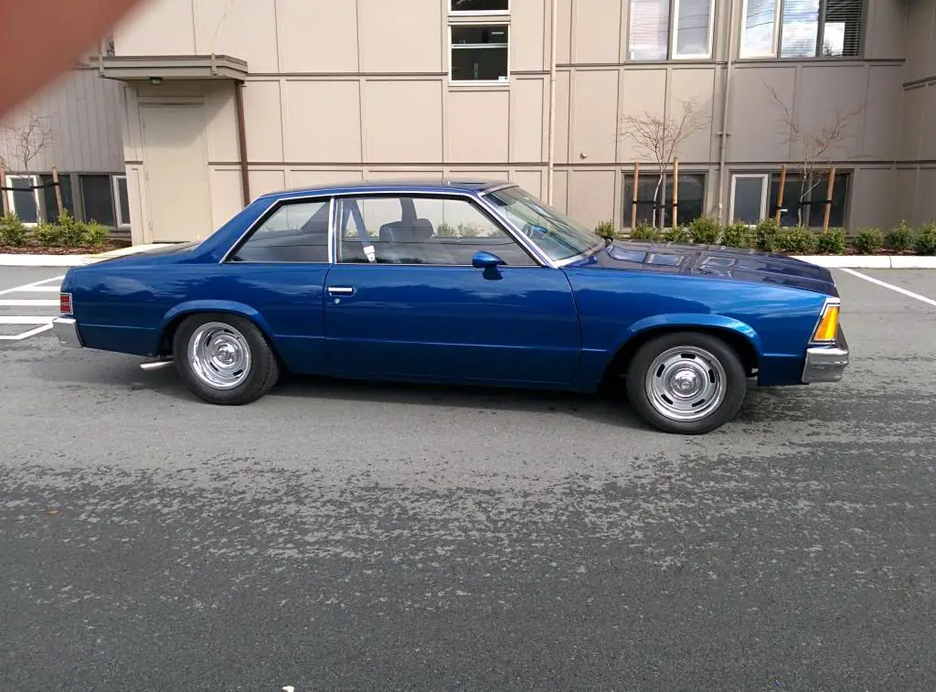

I enjoy sharing thoughts here but consider that what I share is based on my research, building my car, and now add to that working for a great pro touring suspension company. When I designed my suspension I intended to make a presence at autocross events with a car built on a budget. I drive it everyday, but I'm pretty serious about going around corners as fast as I can. In time you'll see even more changes to the suspension as I get out to more events and hone my driving skills. I wanted to throw this in as if to say what I might suggest is because of the way I drive my car and may not fit everyone's build. On the other hand, my philosophy is if you're gonna build it, you'd just as well set it up so that it does well when you do go to the track. Even if you only occasionally see track time, at least you know your car is better than your driving skills and not boring because your skills are beyond what the car can deliver.
