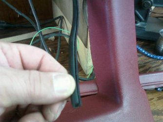

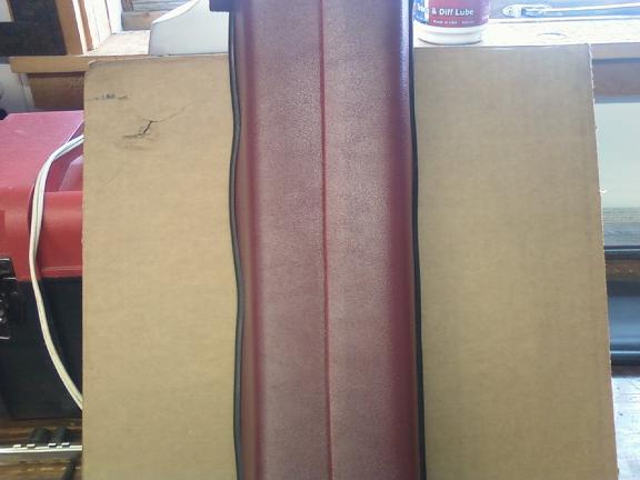

Started putting the interior back in after paiting and adding new replacemant parts. Only thing new was rear speaker tray cover. My plastics came out good after paint and still good shape other than the front side of side window. This is a trick I have picked up over the years building these cars. Most of the time that area is sun faded and warp, also turning to plastic dust! I have always used small 5/16 rubber hose to fix the flaking and warp as you can see pics. Maybe helpful tip for some of you.
