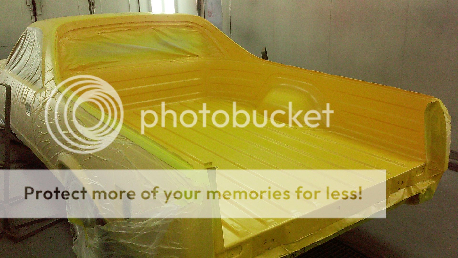

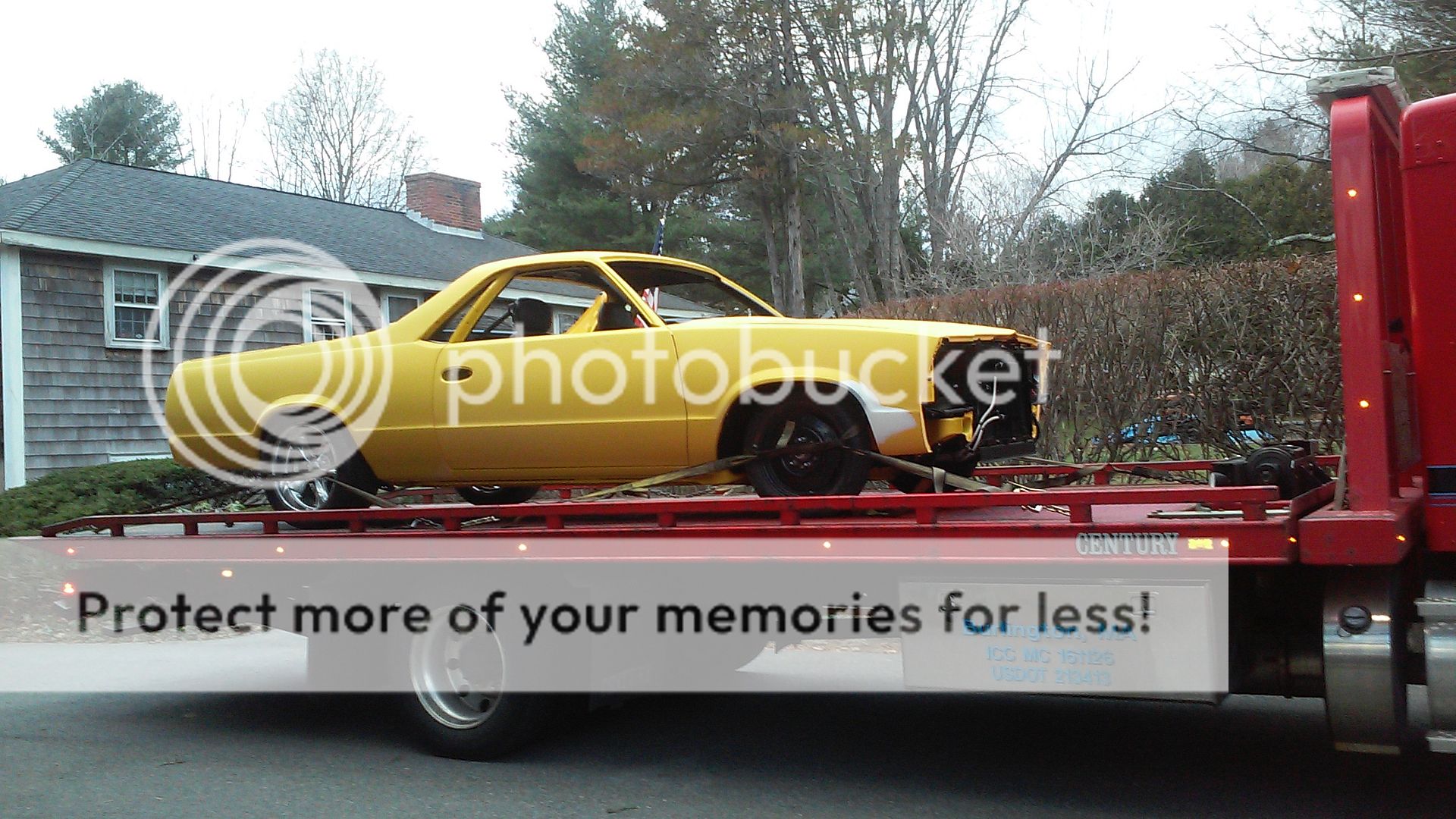

thanks MR,it's getting there :)

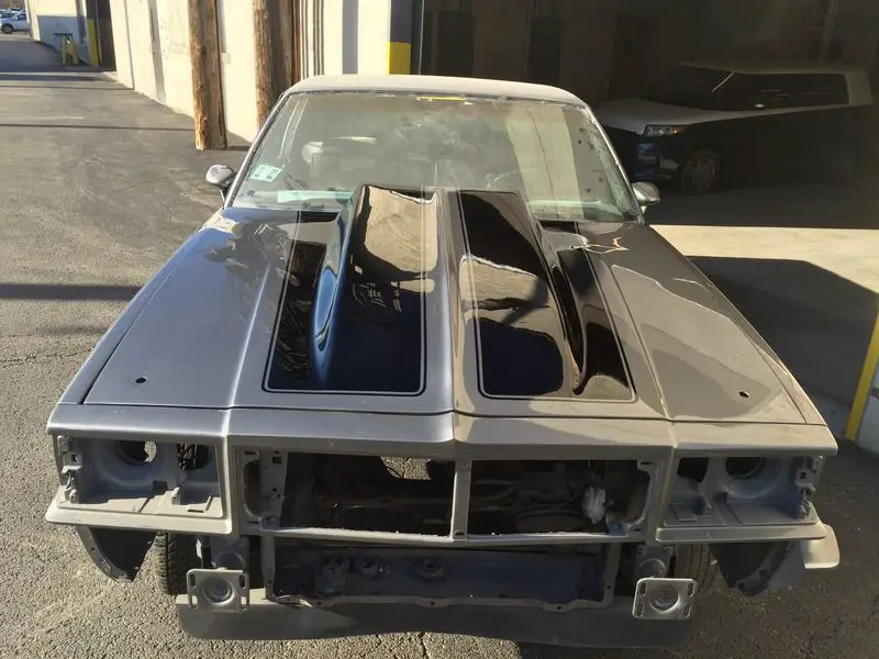

sixty7rs said:
Paint the hood
You missed 2 spots... :lol:
Looks great!
