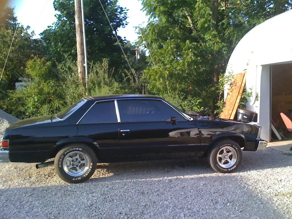

I changed for a all steel BBC to a all aluminum BBC And My front is almost topped out it is way to high. Here is a pick of how it is now.

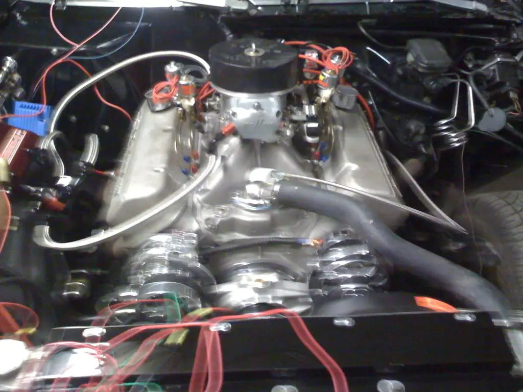

10secBu is right on the money. Back when my BBC was NA I had stock SBC springs in the front. I even cut one coil off to get ride height where I wanted it. Even with the spring cut I still had 4 - 5" of travel, and used to pull 1.40 60' times with cheap gas shocks on the front. Btw your car looks awsome. Need to see some engine shots.

I dont have any pics with Me after I got everything hooked up but here is a couple took during the last build.
