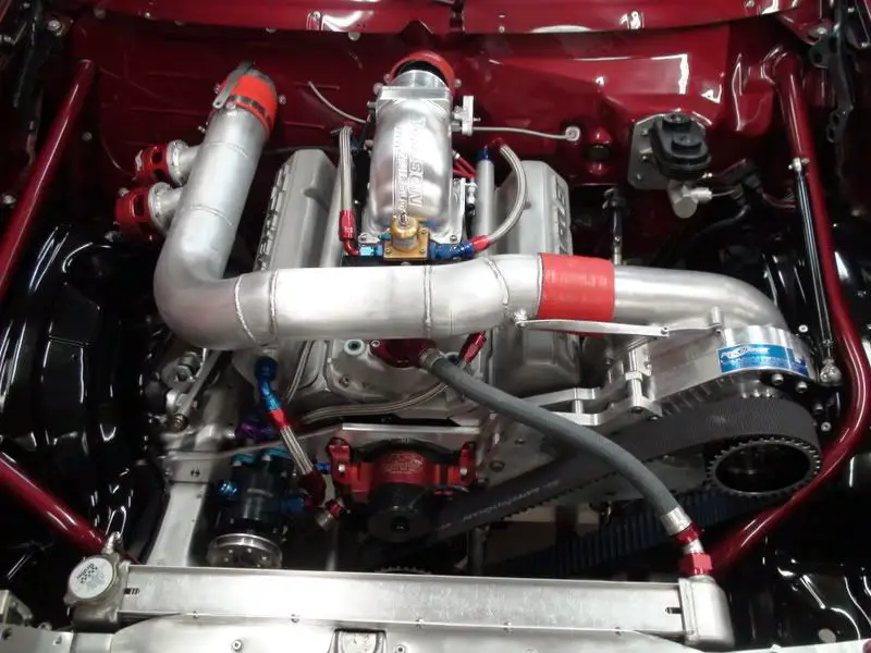

I just used Dupont Imron gloss black. I sand blasted them to give a rough surface for the primer surfacer to stick to. Primer filled them and then sanded them down smooth and shot them with the Imron. Picture doesn't show them the best, but they look like the paint on the outside of the car. Super glossy.
Won't the Imron crack like crazy on a flexy part like fender liners?

first I tried the Krylon Fusion and didnt like the looks of it. It came out to glossy. The I was told to use Wurth trim paint and it works the best and wont flake off and has a perfect satin finish looks like factory.
http://www.autogeek.net/wufltrpa.html
here is a picture with the Wurth trim paint on the inner fenders.
