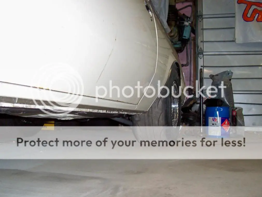

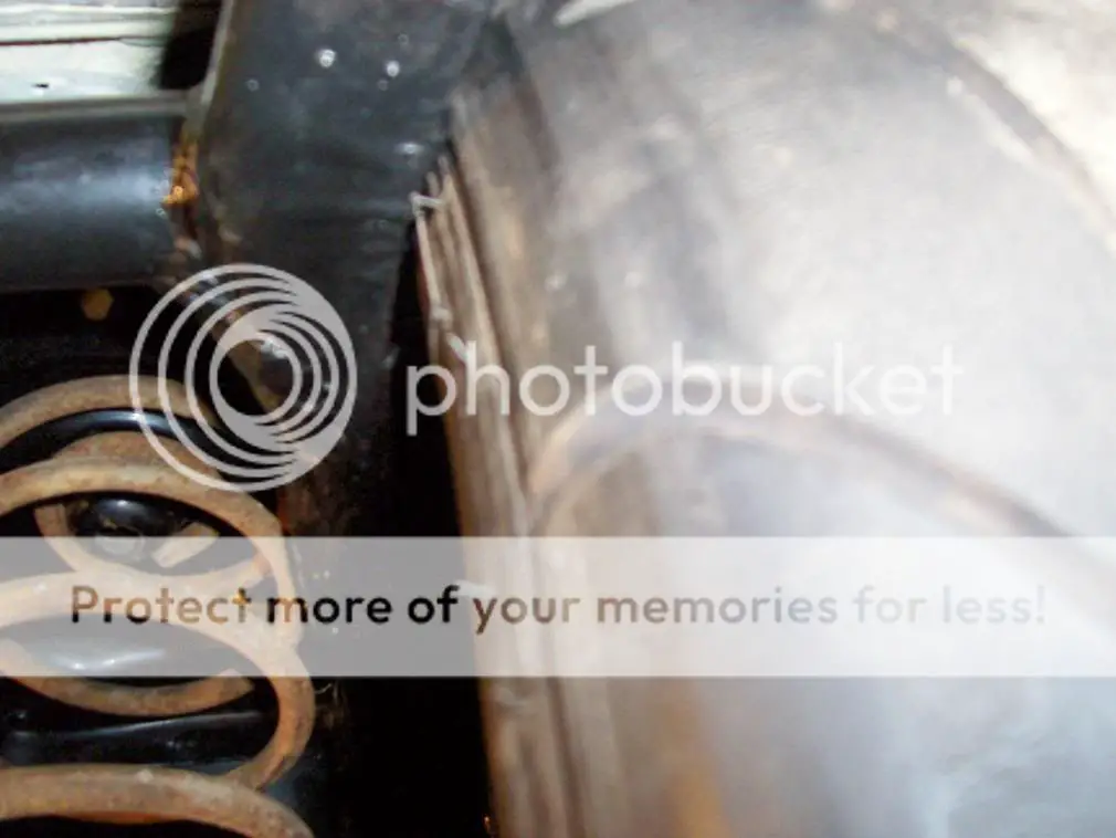

Deep frame notch is done, MT 275-60 drag radila on a 10 inch rim fit sperfect...Would like to try the 325-50...Anybody have this size with stock wheel wells?
I do... very very tight and it might actually work. I'm afraid that hitting a bump/dip might put it in the 1/4 panel. The rounded shoulder of the tire is about even or just inside the bodyline and litterally have under 1/16" clearence on the frame-sidewall in the pics of it on thpass side. The pics of it on the drivers side aren't good quality and you can see how it kinda sticks out. The rear is half a** centered in these pics so with it centered it might just have enough room. I believe it's off about 1/4"-3/8" outward on the drivers side. My notch is even with the tub.
the 275 looks tiny
