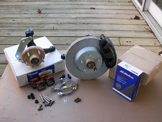

Once thats done, this is next:
dirtybird
May 26, 2010
43
THAT'S WHAT I'M TALKING BOUT DAAAAWWWWGGG!!!!!!!!!! party_dance.gif MAN YOU KEEP RAISING THE BAR. =D>
