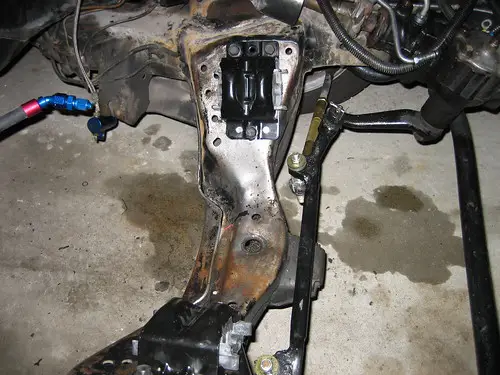

Hey-
Can you provide any detail shots of the PS engine compartment as well as the front of the engine? I would like to see header/AC box clearance and accessory clearance out front. Thanks!
MD
388bu
May 27, 2003
3,228
Huntley, il
www.shiftn6.com
mjdwyer23 said:
Hey-
MD
Have you seen these yet? http://www.flickr.com/photos/388bu/sets/72157607400245239/detail/
I cant get any additional pics until April as the car is locked up tight for winter, sorry.
