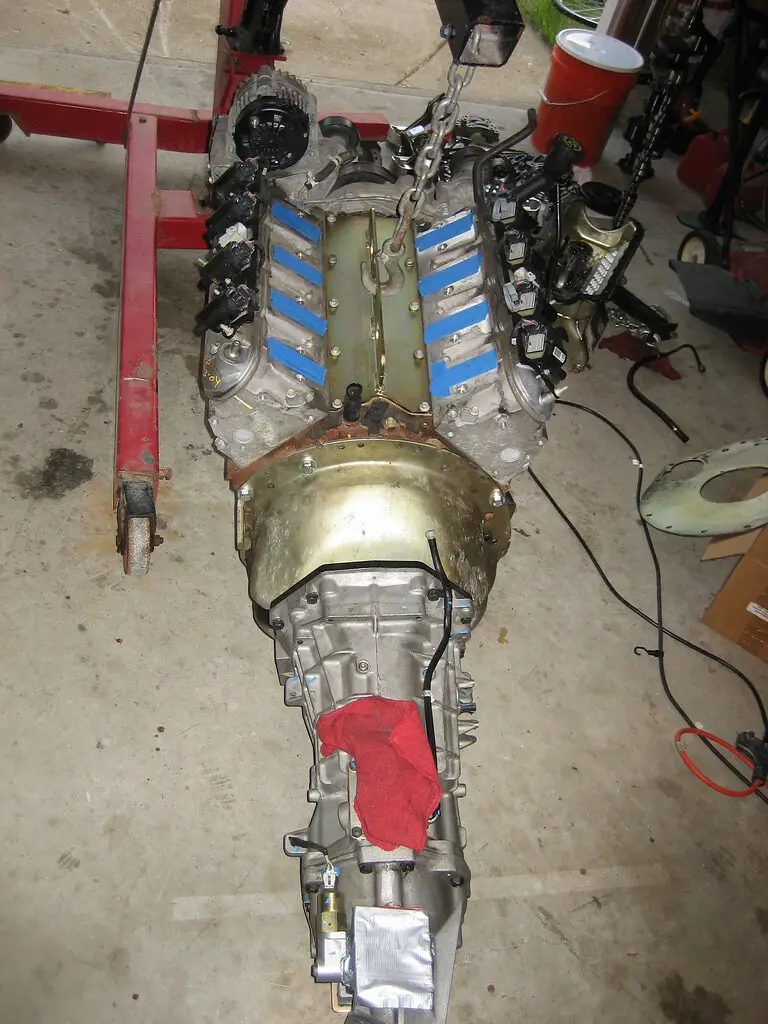

Small update.
Bolted my old bell and the T56 up to this sucker today to very that the transmission input shaft extended far enough into the crankshaft and it does! Woo-hoo! I ordered a McCleod flywheel that is .400 inches thicker so that brings the flywheel surface back to where this aftermarket T56 is expecting it. I also ordered a McCleod adapter pilot bushing as its made to sit in the very end of the crank which is about a 2" opening instead of the 1" or so standard SBC opening.
So I dropped her in to see where my shifter ended up. It is 1.25" forward of where it needs to be. I am not sure how I will solve this. Maybe some slotted LS1 to S10 mounts or the transdapt 1" setback mounts. P/N 4575.
Miraculously, this swap is getting cheaper than I thought the further I get into it. I swear, its like Rod Serling is gunna be in my living room any minute now. lol
And an obligatory pic...
