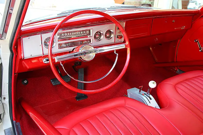

Now that's pretty snazzy!! Have to find a top notch upholsterer to do something like that!
