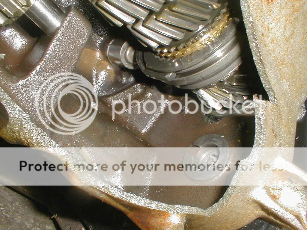

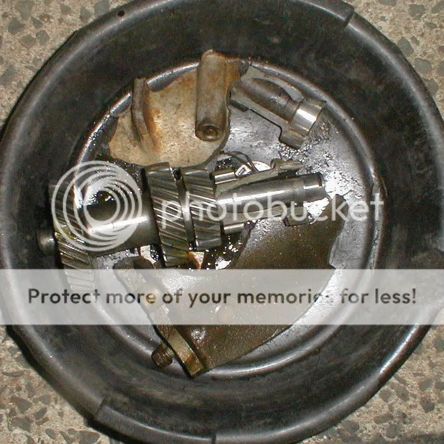

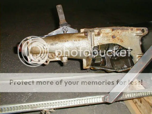

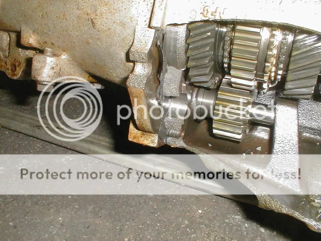

Did you ever see the pictures of my exploded 3.11 Saginaw? It was behind my 305. It did not like a first gear clutch drop while already in motion, which I had done many times before. First gear peeled off the cluster.

It was the weirdest thing, I simply forgot it was in gear when I started the car, and I let the clutch out while the engine warmed up a little... stalled, started it back up and then I heard it from the moment I left the parking spot.

I looked at the pictures again and the tailhousing is from an H body, so it is likely a 4 speed. Check the number of rings on the input shaft to determine if the first gear is 3.50 or 3.11; those were the only 2 ratios that came an H body.
