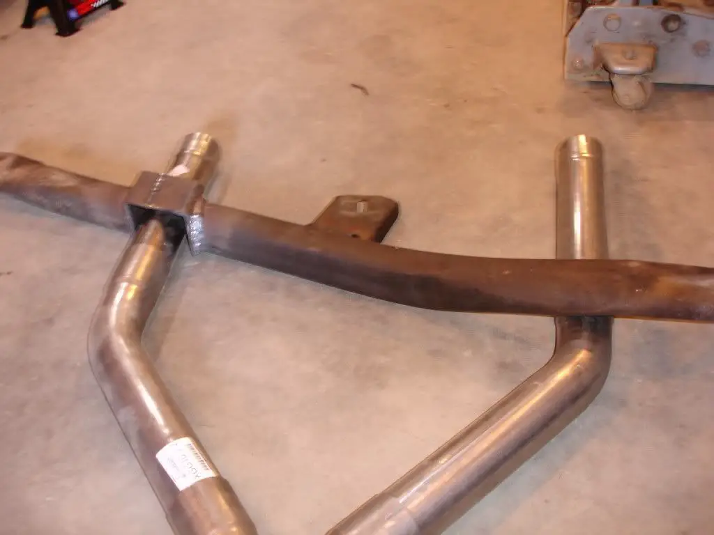

You can modify the stocker too if in a real pinch. Done that a few times before
Notched mine, had it welded because we didn't have a welder yet. Bought the widest section of u-channel I could find (I think it was 4", 1/4" mild steel), and ground away pretty much everything but the top of the crossmember, fit just as well as it did without the hump.
Looking at it now I remember... we left a strip at the bottom so we would have more clearance up top after setting the channel in through the top of the crossmember.
