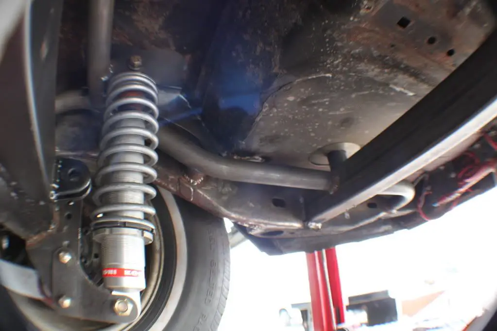

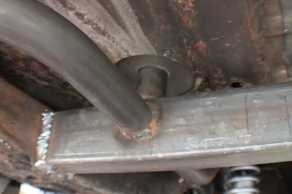

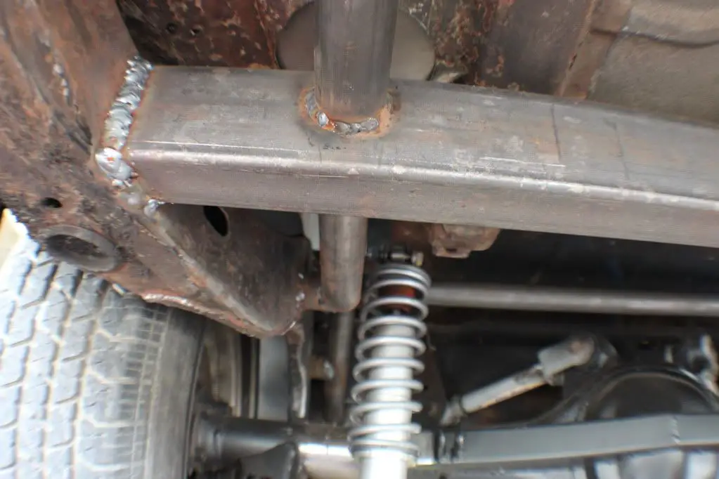

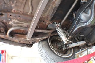

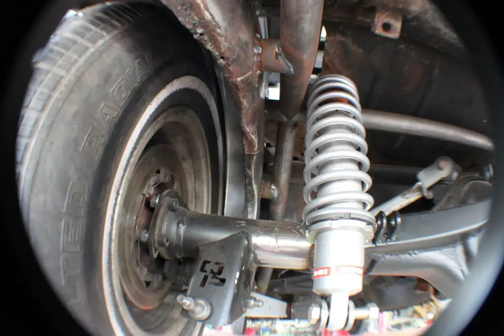

Here's some pictures of my ideas on reinforcing the frame after it and installing coil overs. Tied roll cage in while doing it. Watta think? - Steve
Oh yea, gotta do that. Not done fabin yet. LOLshadychevyowner said:looks good. Run a tube over to upper control arm mount i have heard of the cross members bending.
