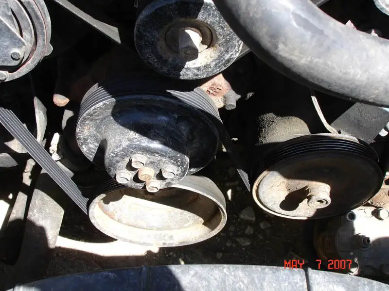

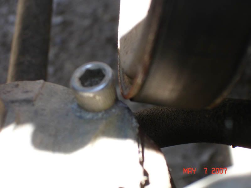

I see you're using the steel horseshoe... hopefully you have a round cover steering box, otherwise you'll run into pulley interference issues.
This was after grinding on the box cover.

...Pheww..Thats close..Yes i have the round one!

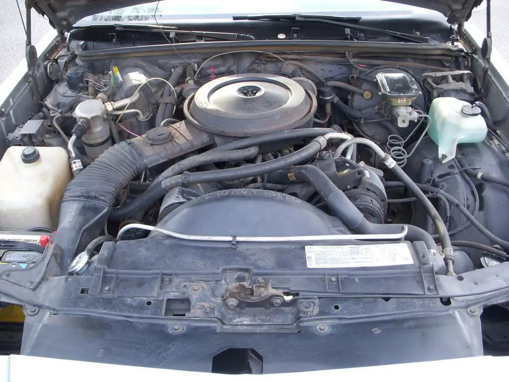

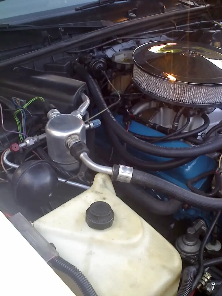

couple of pics with the motor finally in the car.
I cleaned up the A/C unit and lines with a little aluminum wheel polish. The motor is running a comp-cams XE262H-14 cam ( 464 / 470 lft ) with roller rockers, steel crank, pink rods with eye-browed pistons, and a set of patriot performance vortec heads ( with the old school valve covers to top it off ), which the builder tells me is good for about 10.5:1 compression all with a holley spreadbore carb to top it off.
From this
To this
Can't hardly tell the difference between the new 350 and the old 305 that was in there. dancin_banana.gif
