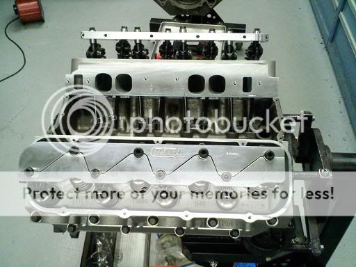

489" BBC 10.27:1 compression ratio oval port Dart Pro 1's (275cc intake port)
solid roller cam single plane manifold

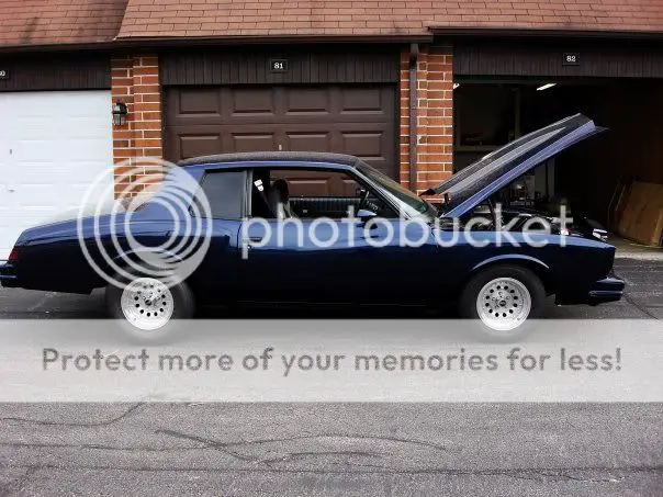

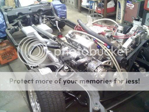

My malibu motor as it sits now:
