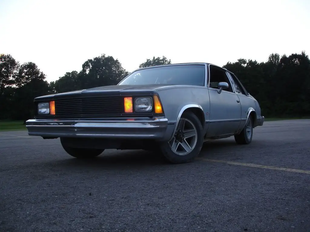

I'm using Hotchkis 1902 springs with Belltech 2" spindles on mine, used stock replacement shocks. Tires are 205/60/15 iirc.

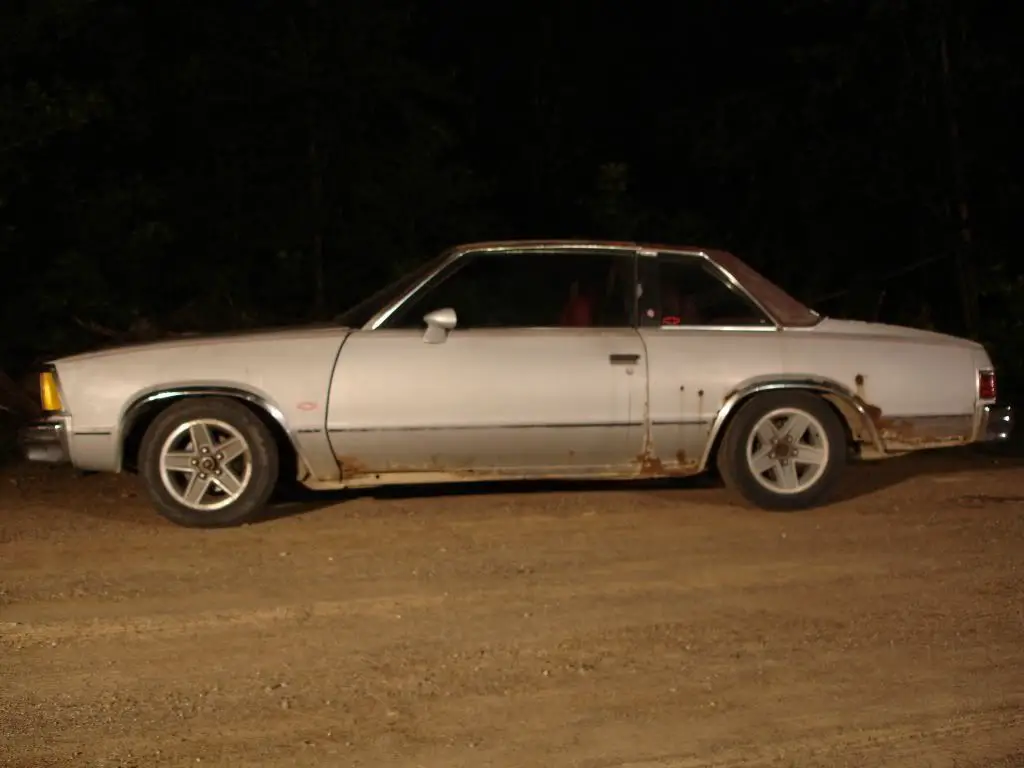

That would be correct I wouldn't doubt the frame has some rot and it's sitting a hair lower due to body mount bushings sitting down in the frame, but it can't be more than ½" or so.
