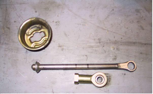

I think different companies use different suppliers. Of the two parts store manual brake master cylinders I have bought, none seem to have the deep pushrod hole in them like the factory ones did. or shall i say like i have heard they are supposed to have. I wish i would have took mine apart on my manual brake bu just to know.
Or was they setup just like the manual brake S-10's with the push rod retainer????
like this
