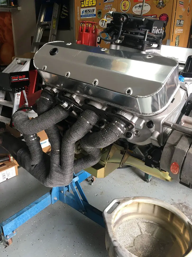

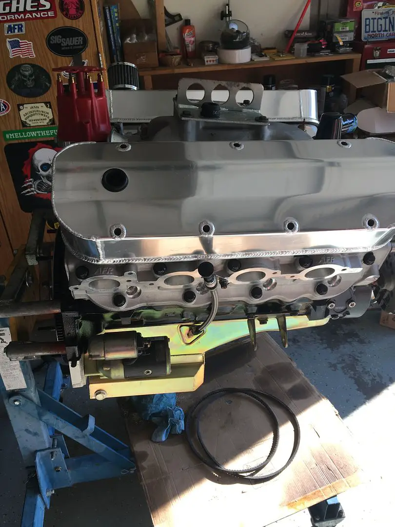

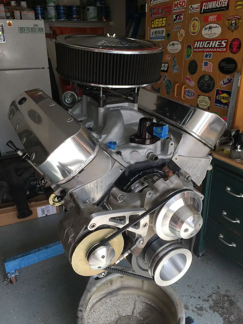

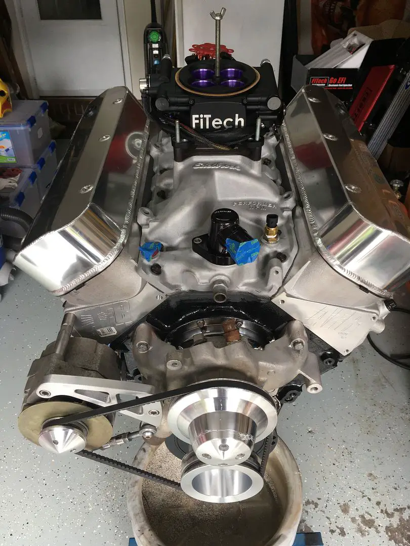

Do those heads have standard or raised ports?
They are AFR Oval Magnums. Raised ports.

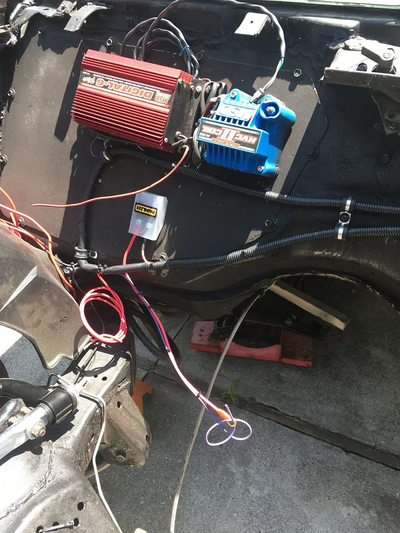

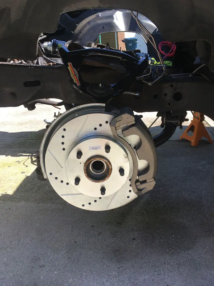

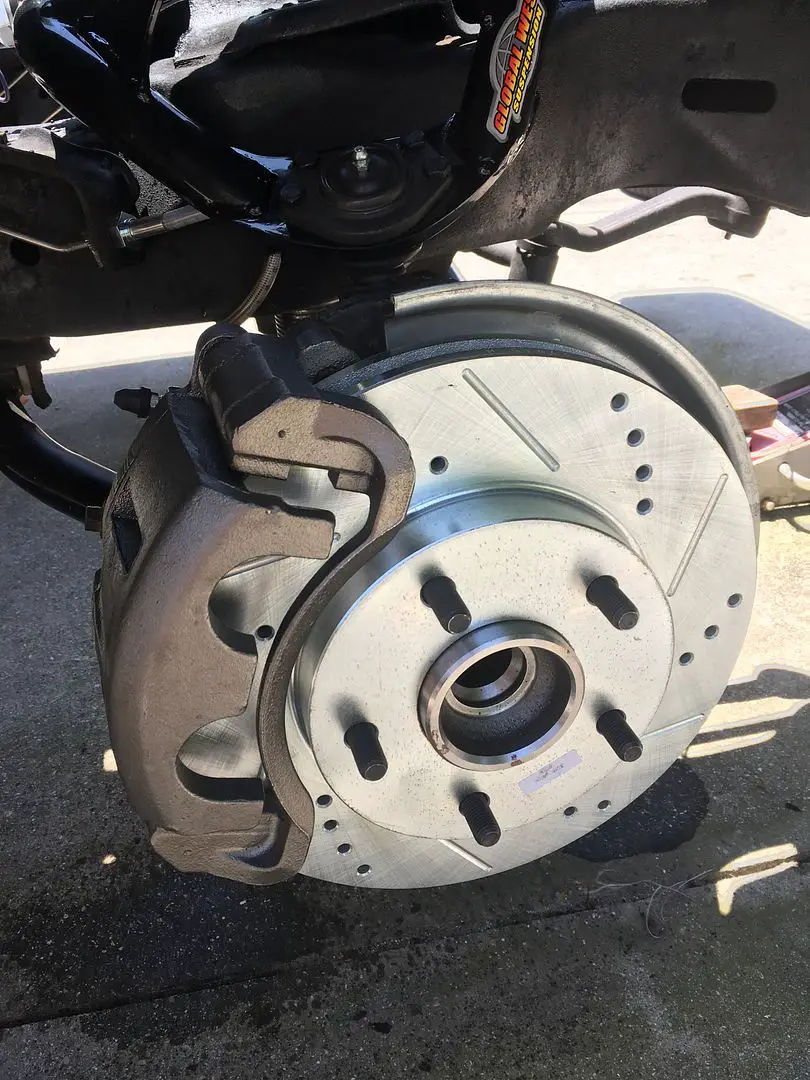

I'm having trouble placing that post in the last pic. Where is it, and is it a ground?
Its a ground lug right on top of the trans tunnel in front of the shifter. It will be hidden under the dash. I was tired of ground to anything I could find. That will tie in to chassis, block and body.
