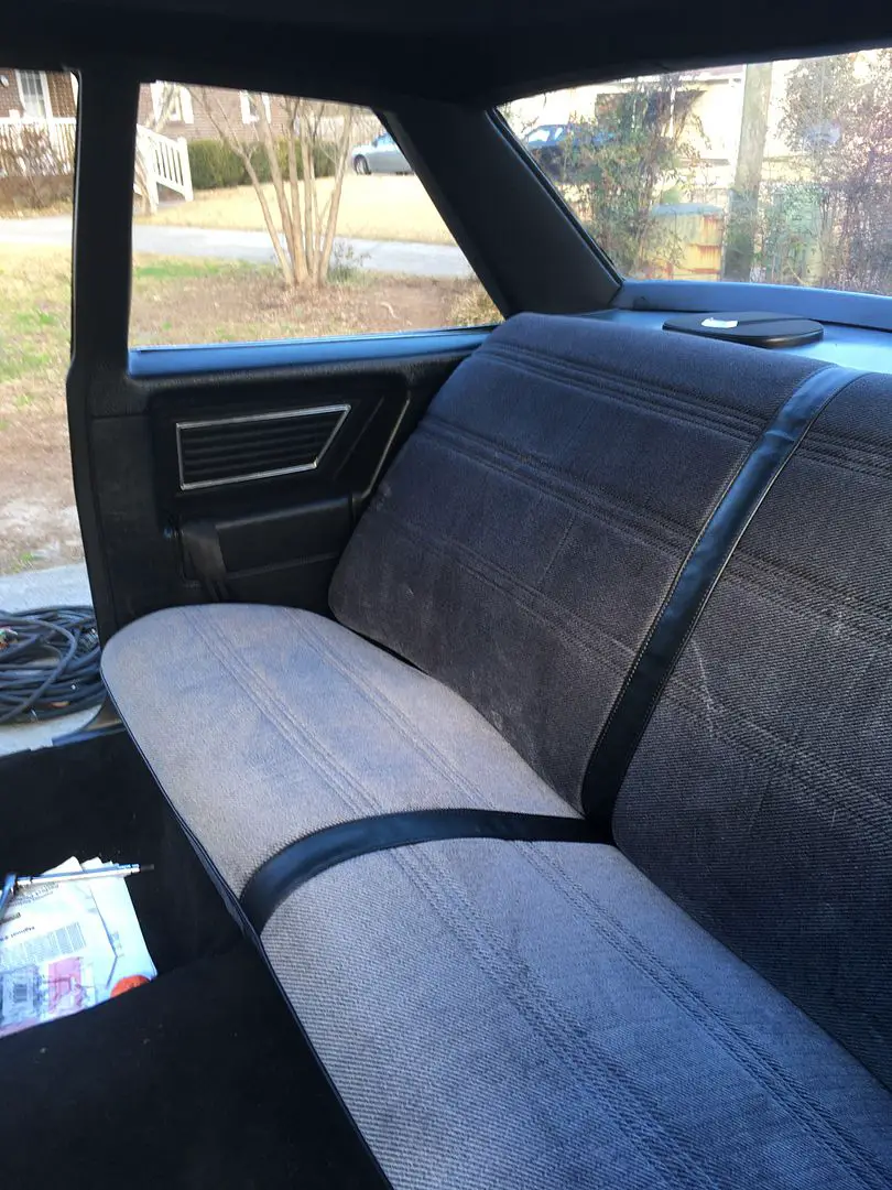

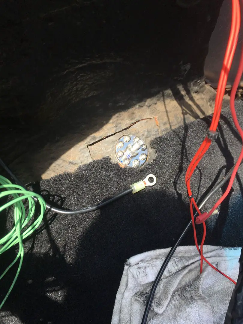

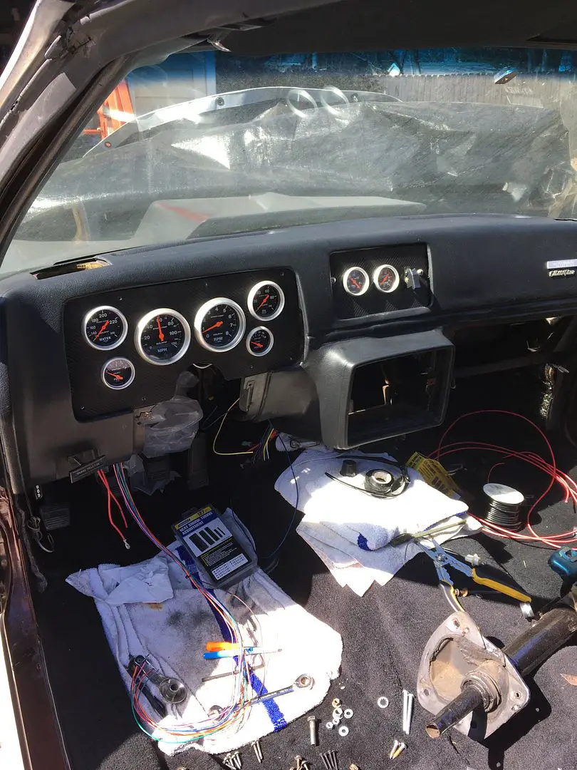

So I now have reverse light circuit working and fuel gauge. Im sure more works but thats all I have tested so far. Just trying to see some of the longer wire runs and how they worked out. Ill never rewire a car EVER again. Not even for money.

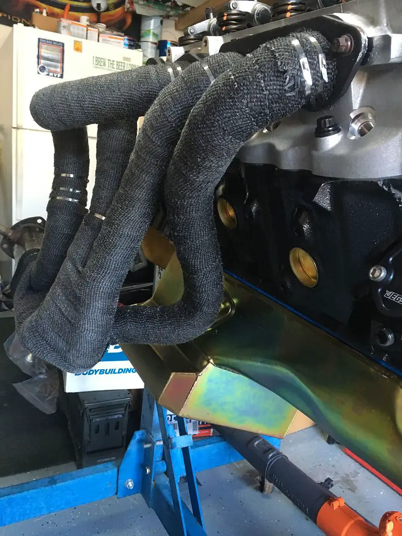

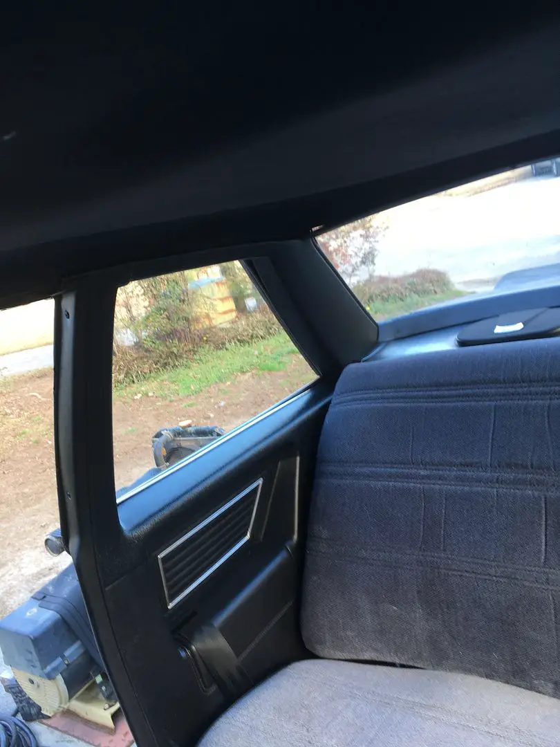

Few progress pics. The back of the interior is done and more or less installed. I know header wrap is not great but I dont care... cuz I like it.

Looking good!!
Do those heads have standard or raised ports?
