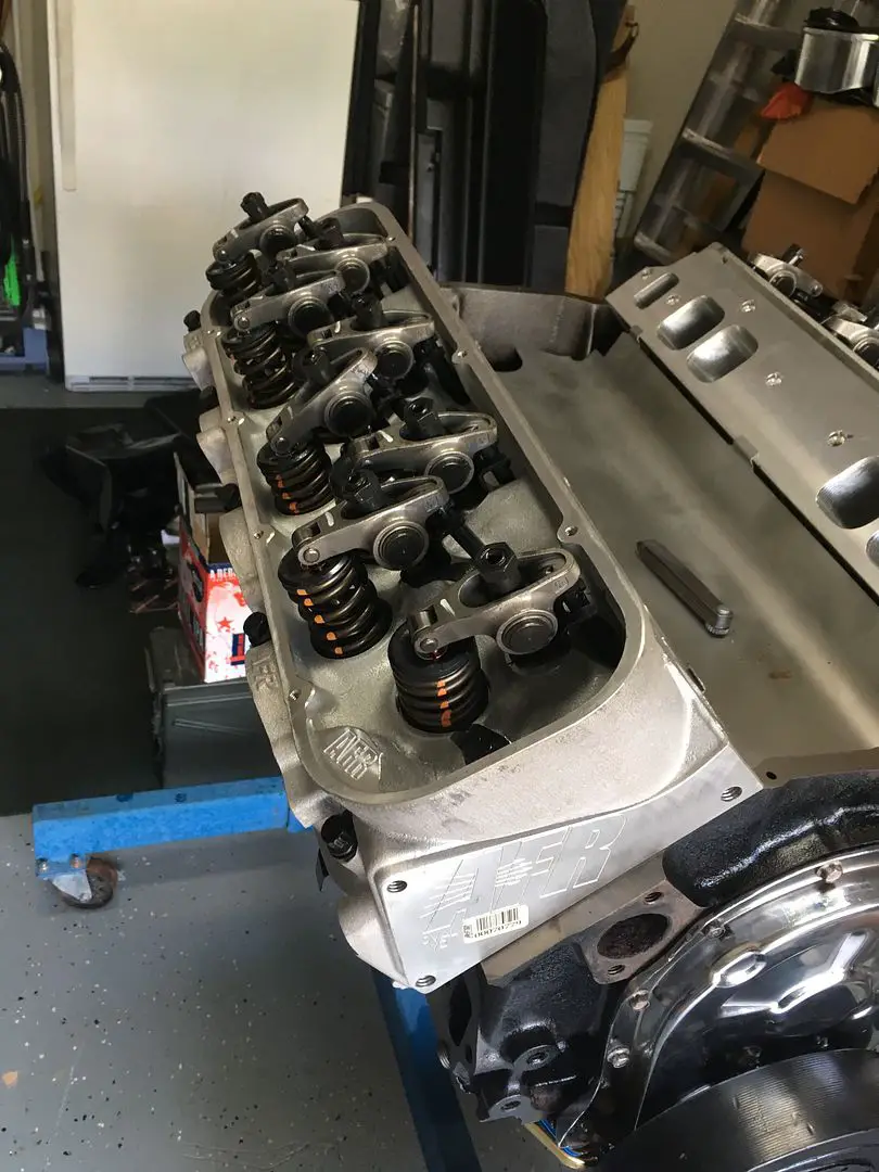

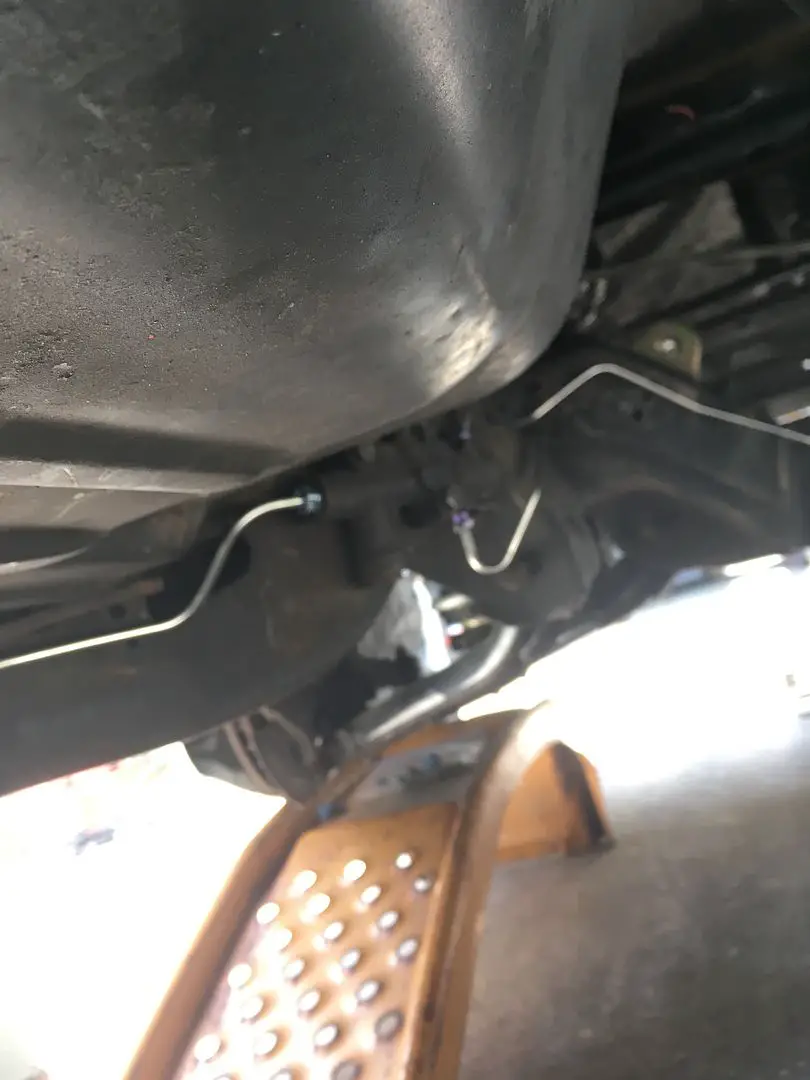

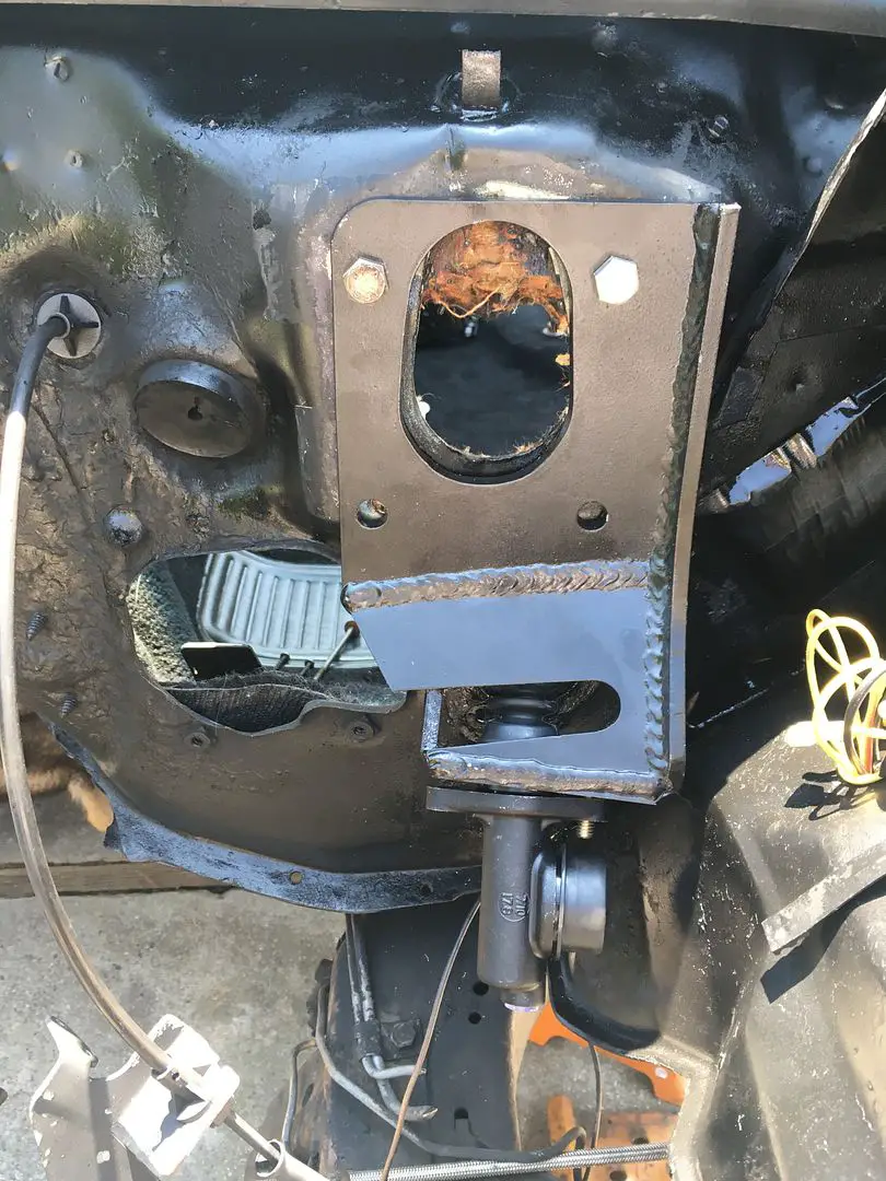

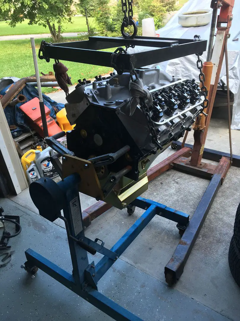

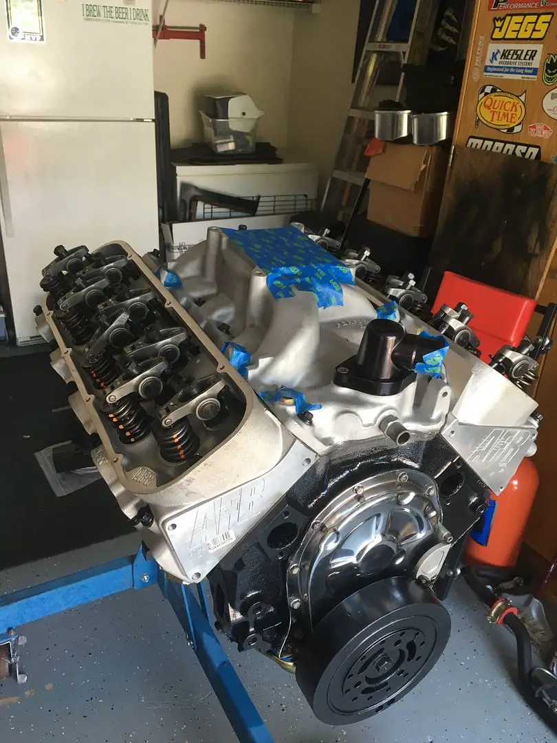

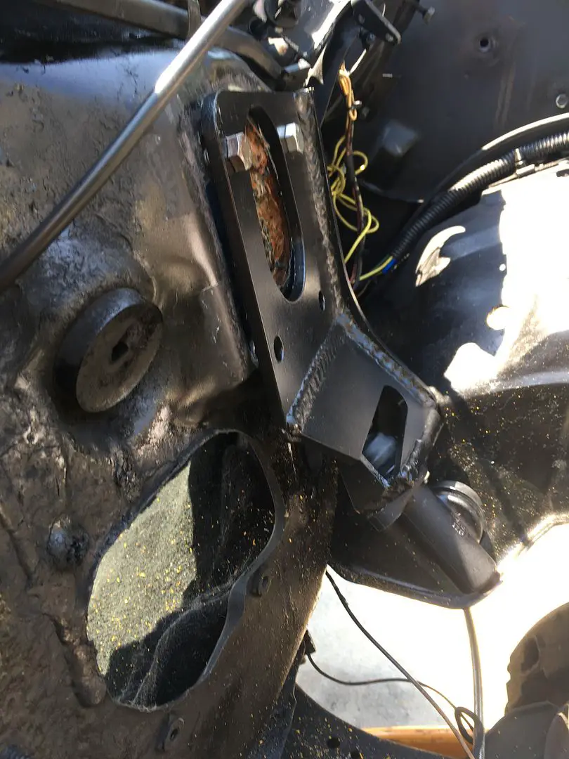

496 is done. Reused cam from 454. 231/238@ .050 with 600 lift on a 111 LSA. Going to try the Slick Speed Monte clutch setup. The Bdzel pedal effort was destroying the firewall. New brake lines. All kinds of new stuff. Just makes for a slow build.

TURNA said:
What is the difference between the 2 pedals?
The Bdzel pedal has a funky angle so you can use a FBody master. Worked great for years. But the firewall is beginning to crack. The Slick Speed uses a stock pedal with a new master angle that bolts up behind the brake booster. And the Slick Speed setup allows for whatever diameter master you need to get your clutch movement right.
