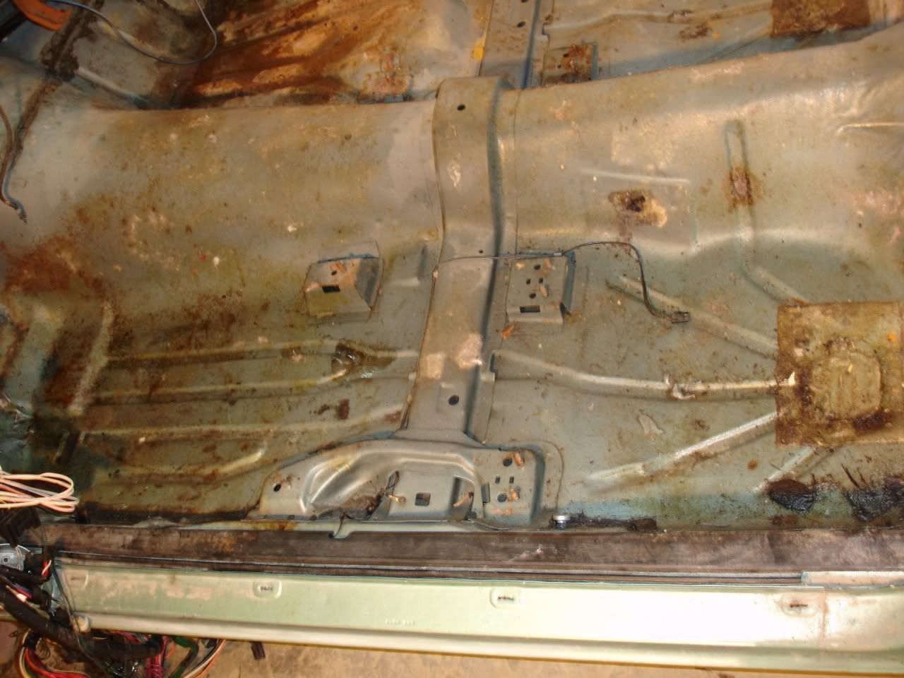

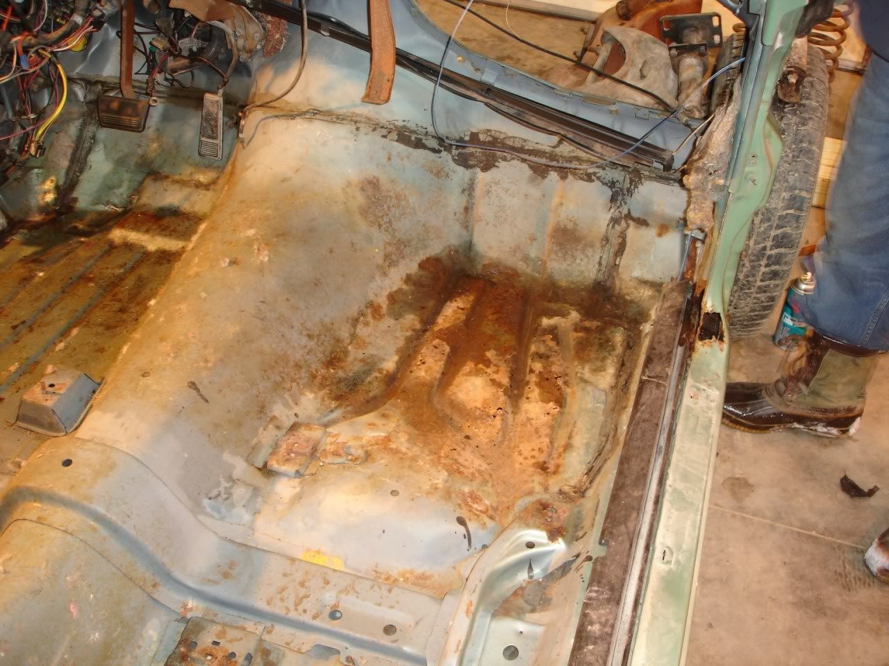

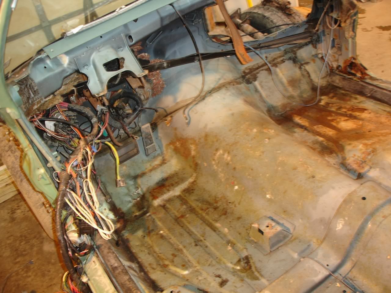

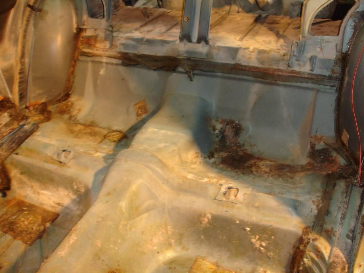

Don't forget to put down some good epoxy or self etch primer and seam seal both sides of the welds with a good two part seam sealer. She shouldn't ever rust again that way. I'm thinking maybe I should snag a few good rust free g bodys from around here. Seems they're getting harder and harder to find.

Looks great! Doober take notes! J/K
