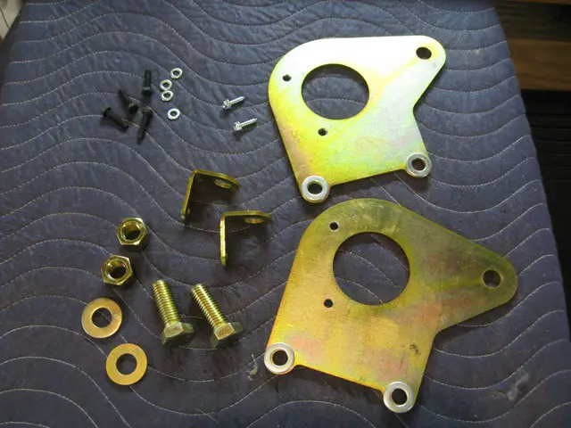

Lookey what I found...
Caliper brackets, bolt on, 10 bolt, 7.5", 3-bolt axle tube flange, metric calipers... exactly what I'm looking for... Circle track racers are wonderful resources....
Here's just the brackets...
http://www.kelleyracingcompany.com/shop/product.php?productid=16168&cat=250&page=1
And here's the whole kit...
http://www.kelleyracingcompany.com/shop/product.php?productid=16214&cat=250&page=1
For pretty much the exact same price (plus tax), you can just go to AutoZone and get the rest of the pieces brand new and under some good warranties, instead of buying the kit...
So pretty much $200 + hoses and a proportioning valve, you too can have a whole rear disc brake setup in about an afternoon using almost all stock parts...

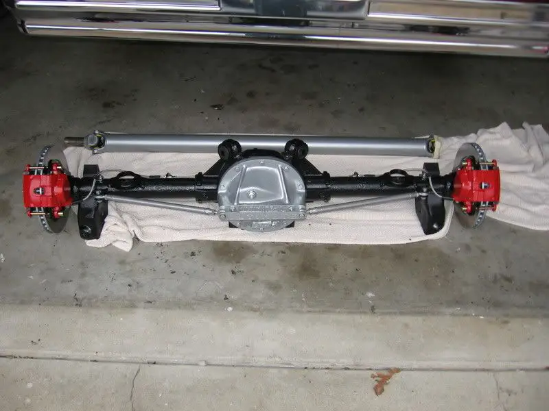

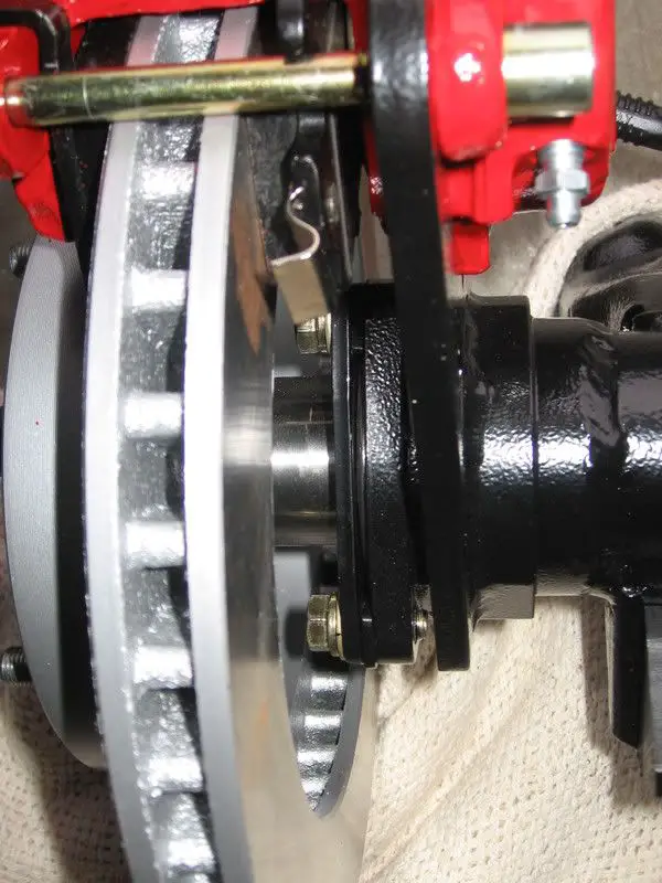

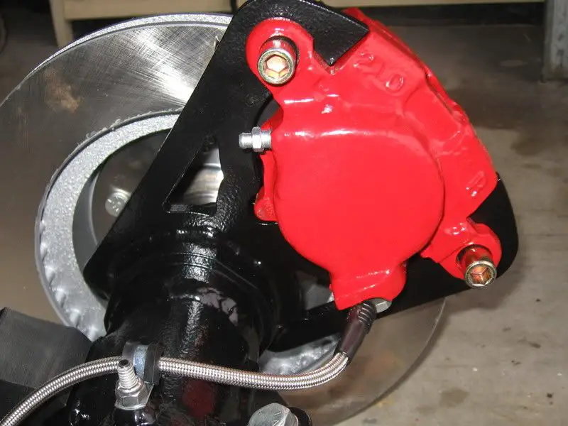

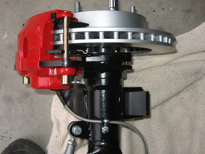

If you don't want to weld you can get a bolt on kit from speedwaymotors as well.
It comes with all necessary items calipers, brackets, rotors, pads, and hardware. Of course, like any other "bolt on kit", it will need some minor fitting, and some new brake lines.
They list two styles:
7.5" GM NON-EMERGENCY BRAKE CALIPERS
Item #: 91031923
Price: $299.99 KT
7.5" GM EMERGENCY BRAKE CALIPERS
Item #: 91031928
Price: $349.99 KT
A few members have used this kit on their 7.5 rears with success. I used the kit for the 10/12 bolt rear 4 bolt flange pattern (I have Moser Ford Big Bearing weld on housing ends with a 10/12 bolt flange on my 8.5 rear) I ended up welding the brackets on though. They would not work right with the Moser ends because they have the correct flange pattern for the 10/12 bolt flange, but the Ford bearing is a lot bigger than the GM so the bolt on brackets would not clear. But with the stock 7.5 ends the bolt on kit would be fairly easy to install.
