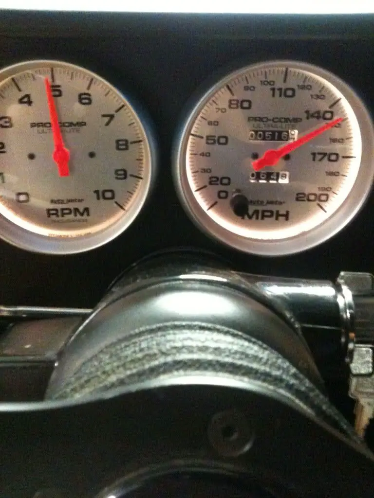

kevind
Jan 7, 2009
868
Whitley City KY
TKO600 in 5th gear tires are 255/60R15 4:10 gears
