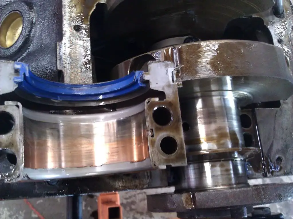

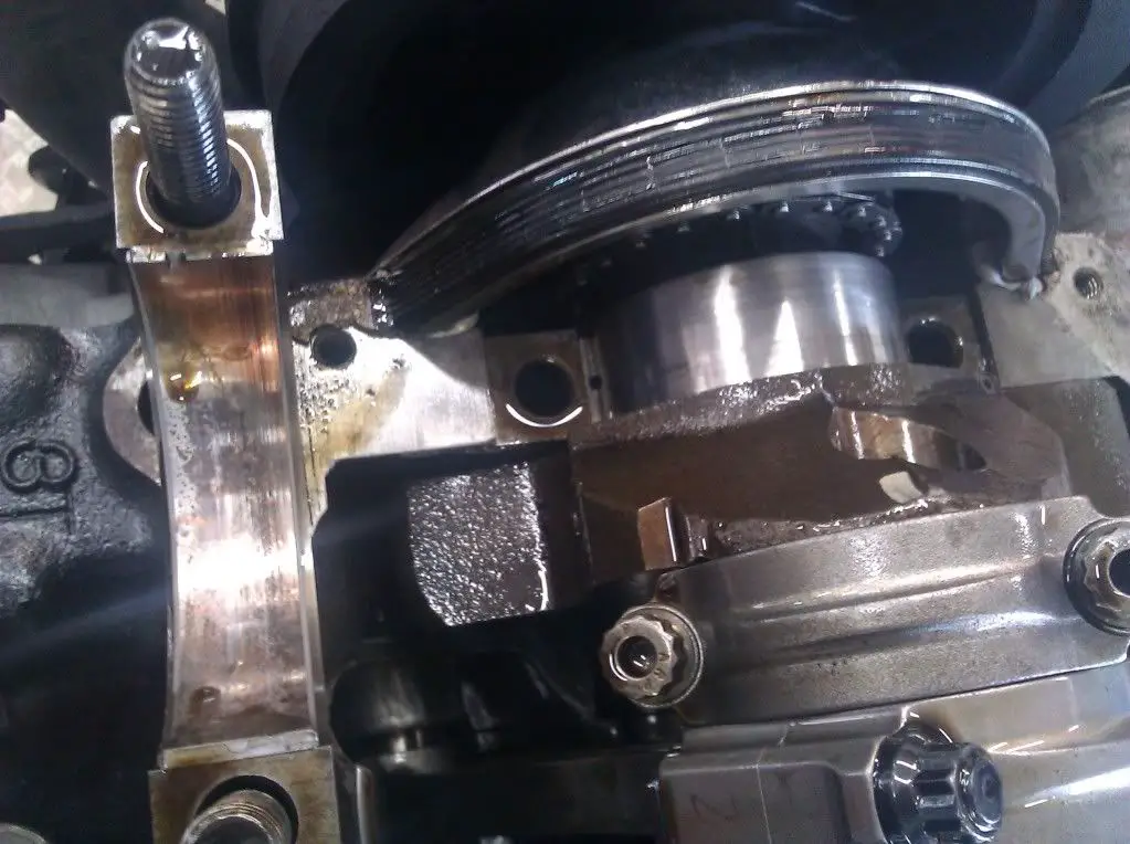

Everything except the flywheel was pulled off. I didnt really notice the vibration when running the motor this way so I think its safe to assume the issue is due to the pilot bushing not being in there. Regardless, damage has been done as the rear main oil leak was practically pouring out when I ran the motor for this short amount of time. I drained the oil and it looked very copper colored with shiney flakey-ness. The oil filter looked the same when I opened it. I assume this just means there is a lot of metal in the oil.
