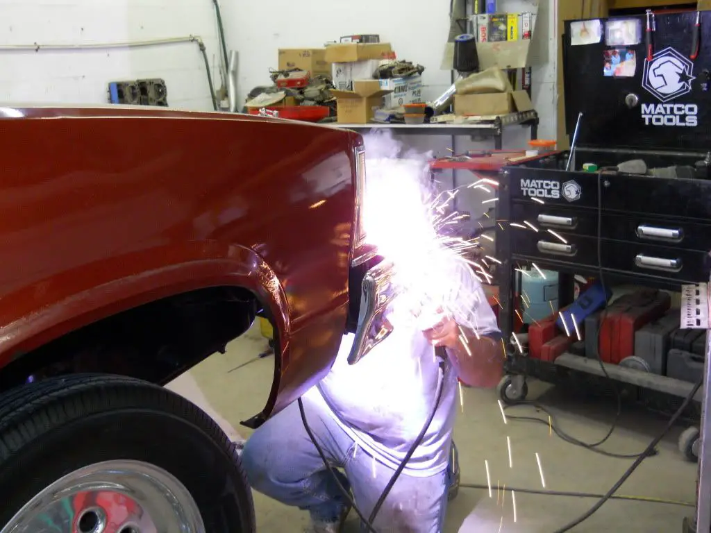

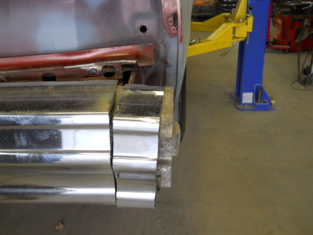

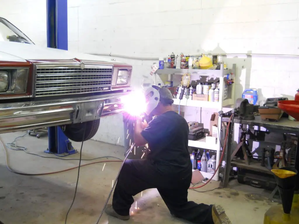

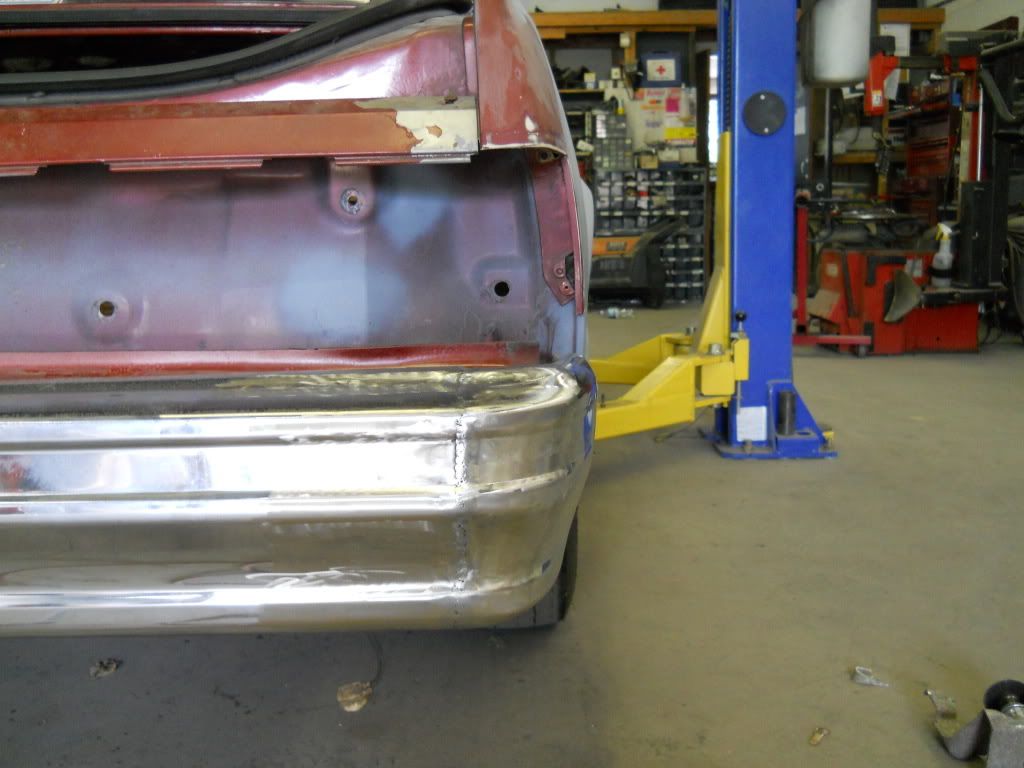

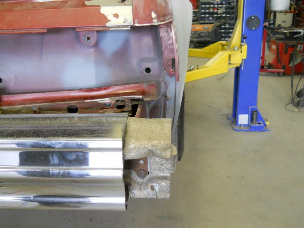

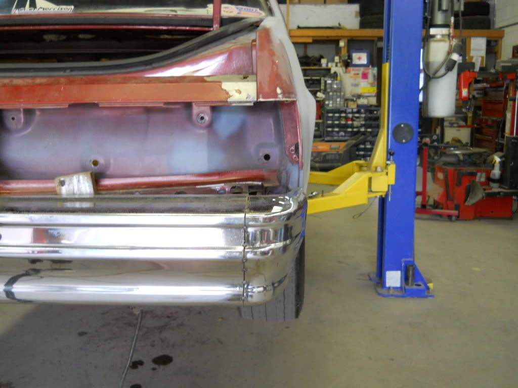

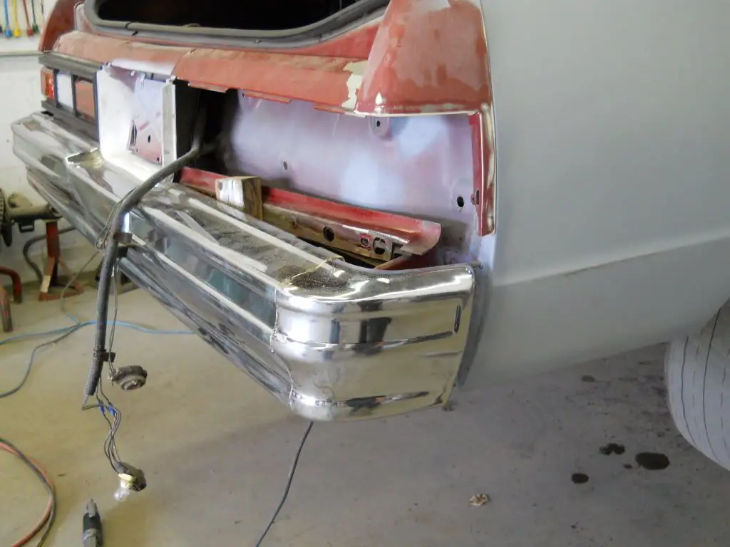

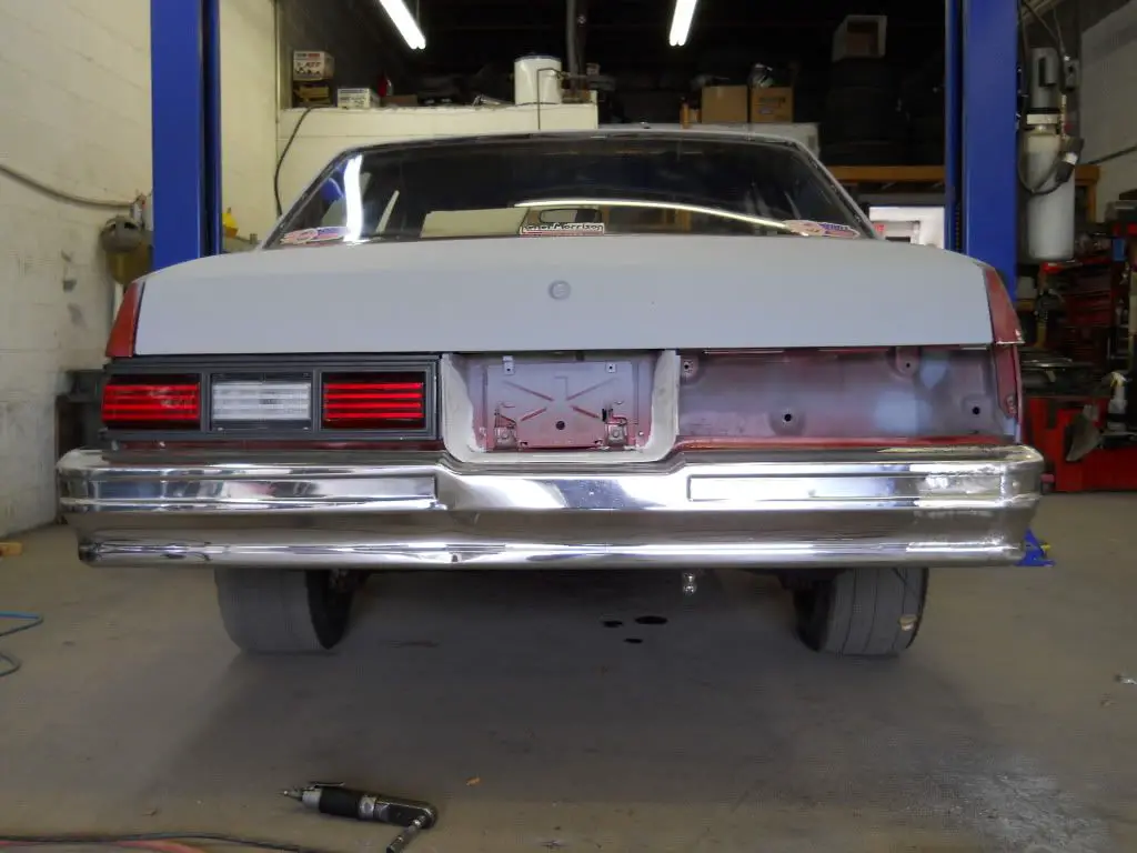

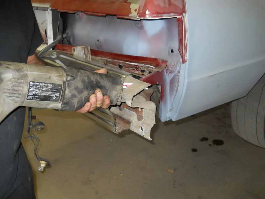

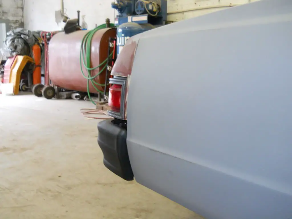

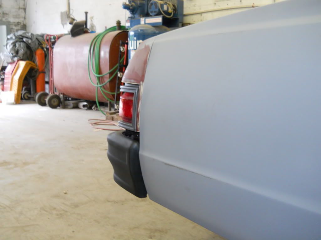

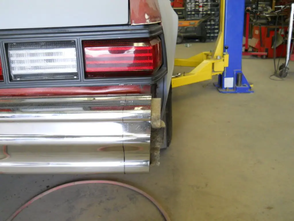

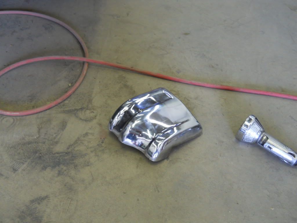

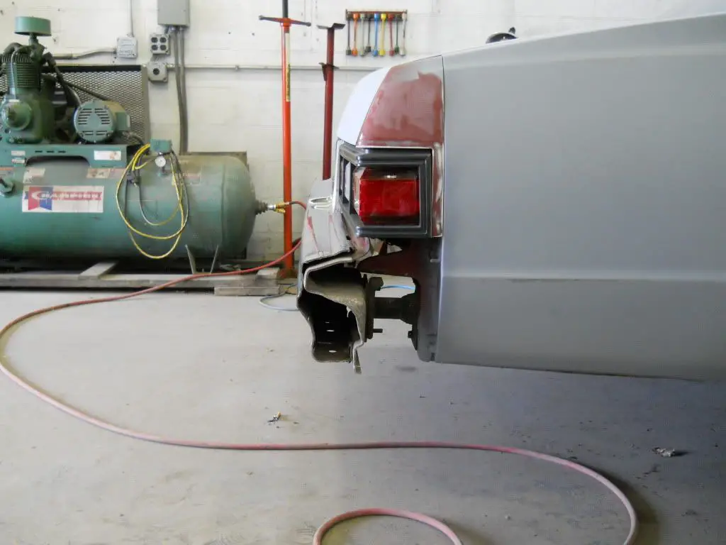

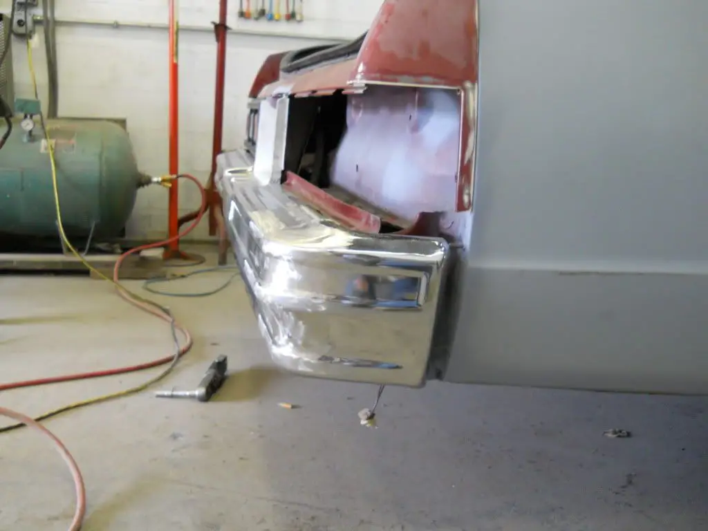

decided to narrow the bumpers before painting the car. Still a ways from paint but getting there,
left side stock, right side narrowed::
CLICK HERE ^
Betcha618
Posts: 327
Joined: Wed Sep 19, 2007 2:32 pm
Location: coram, NY
Contact:
Re: Narrowing the bumpers
Post by Betcha618 » Wed Jul 13, 2011 3:45 pm

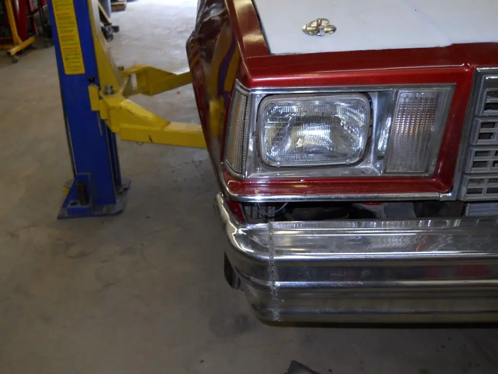

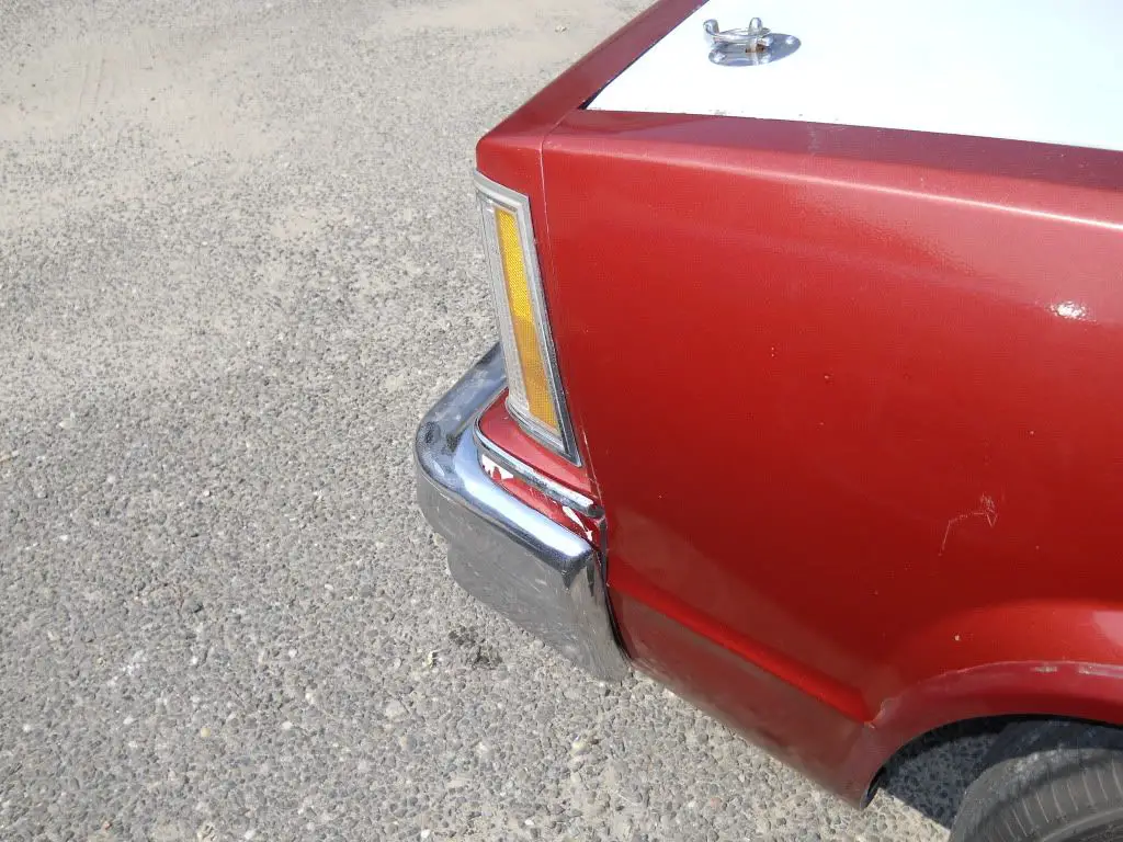

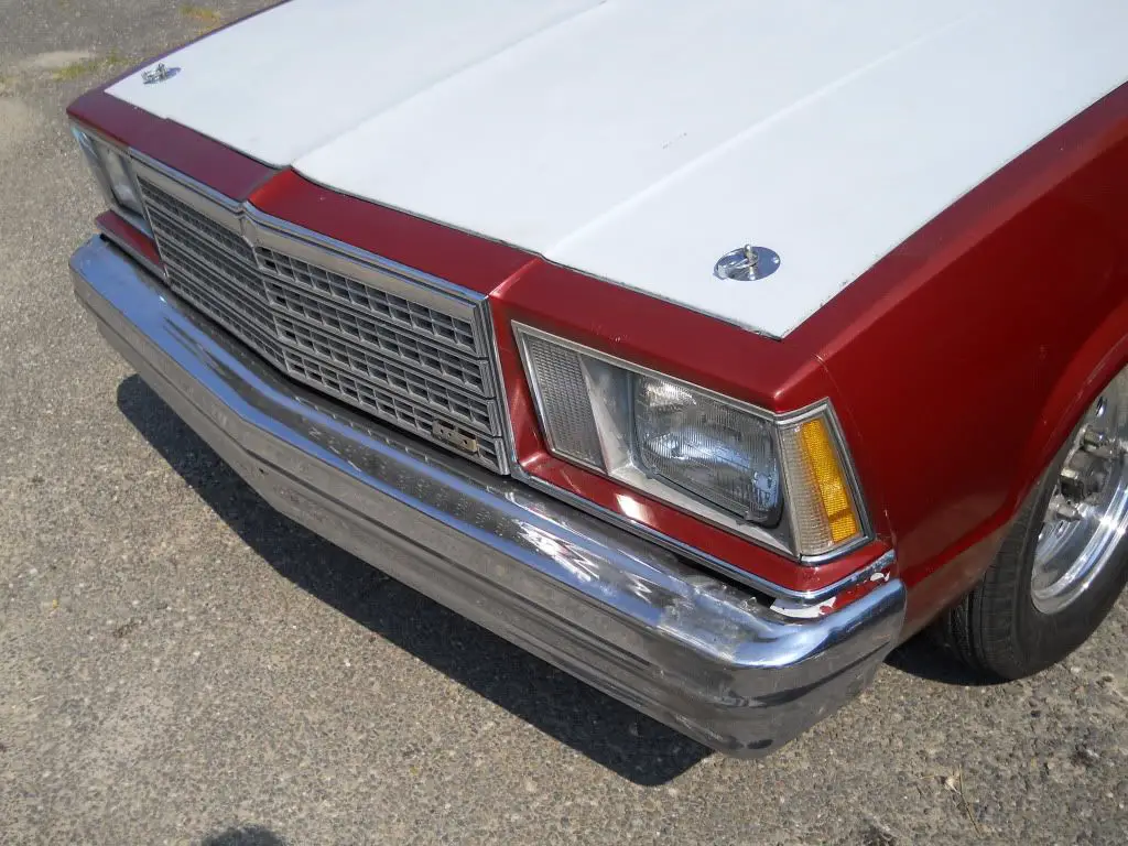

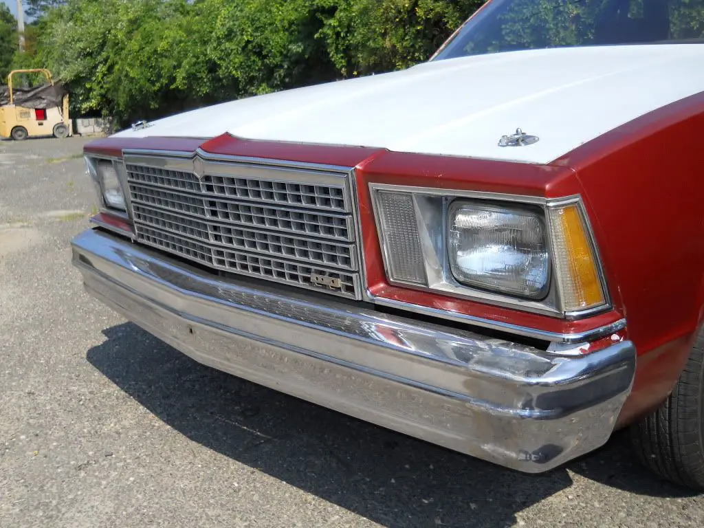

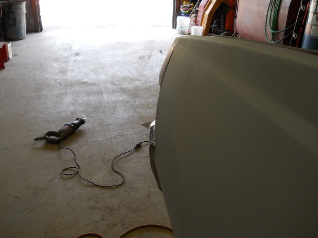

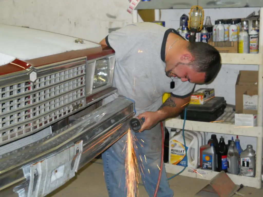

Now the front::
stock:
we also moved the front bumper back one inch

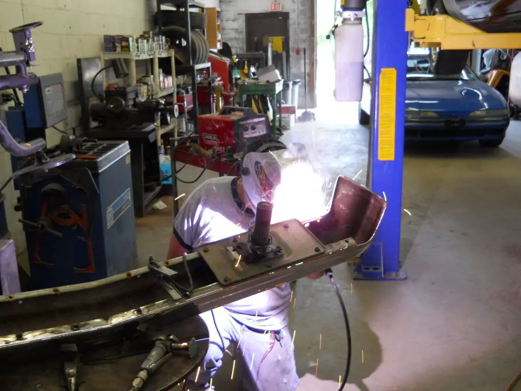

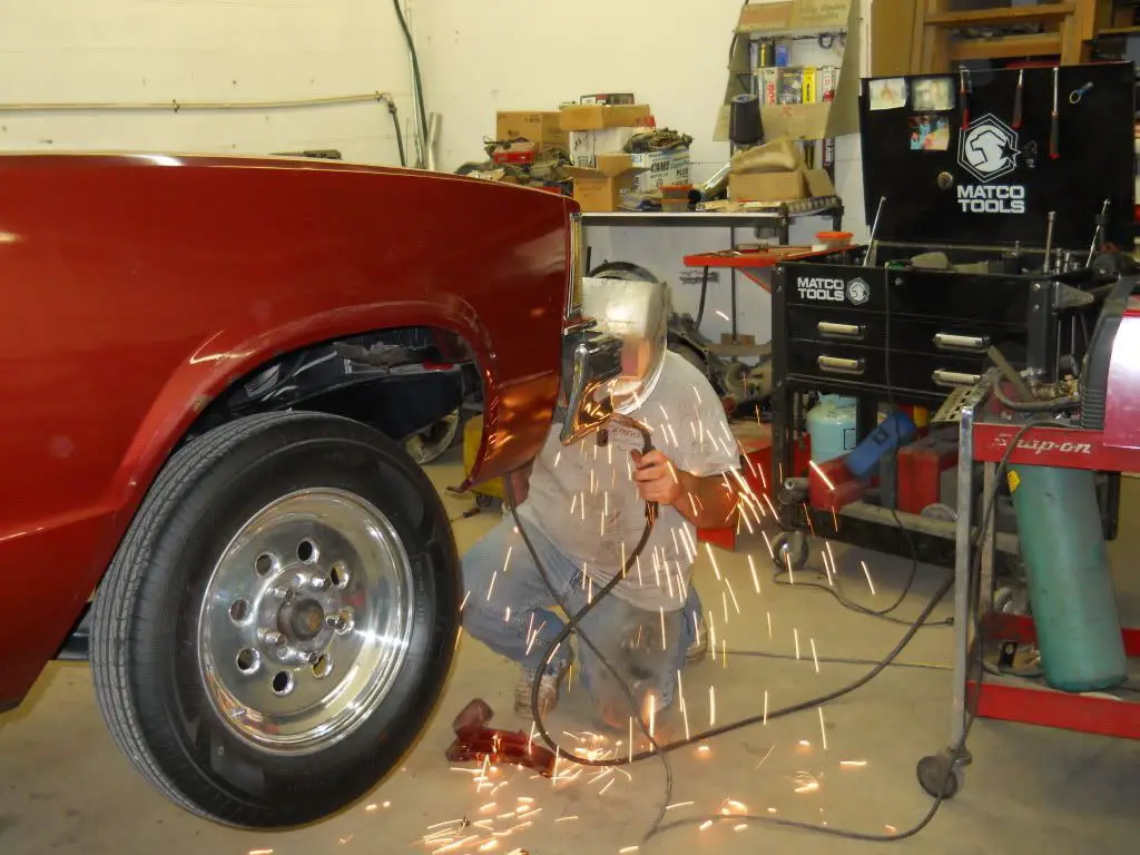

then just finish welding everything up::
CLICK HERE ^

I was thinking of doing the same thing,but i just did know how much to take out. Can you give me some specs on how much you took out? How did you bring the front bumper in 1 inch? I was thinking 1 1/2 inch on both sides,but wasn't sure.

Great work and looks great =D> I pretty much did the same thing with my 80. I only took 1 1/8" from each end and also moved the bumpers in closer by 1/2". Had to fab new rear mounts as the alum. was too far gone. Trimmd the end and horizontal fillers back to fit also. Rechroming cost me a small fortune :-& Plan on paint or chrome? Nice job!!!

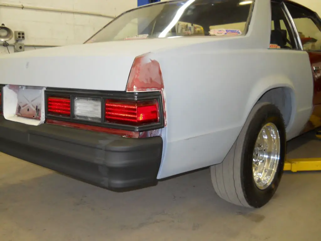

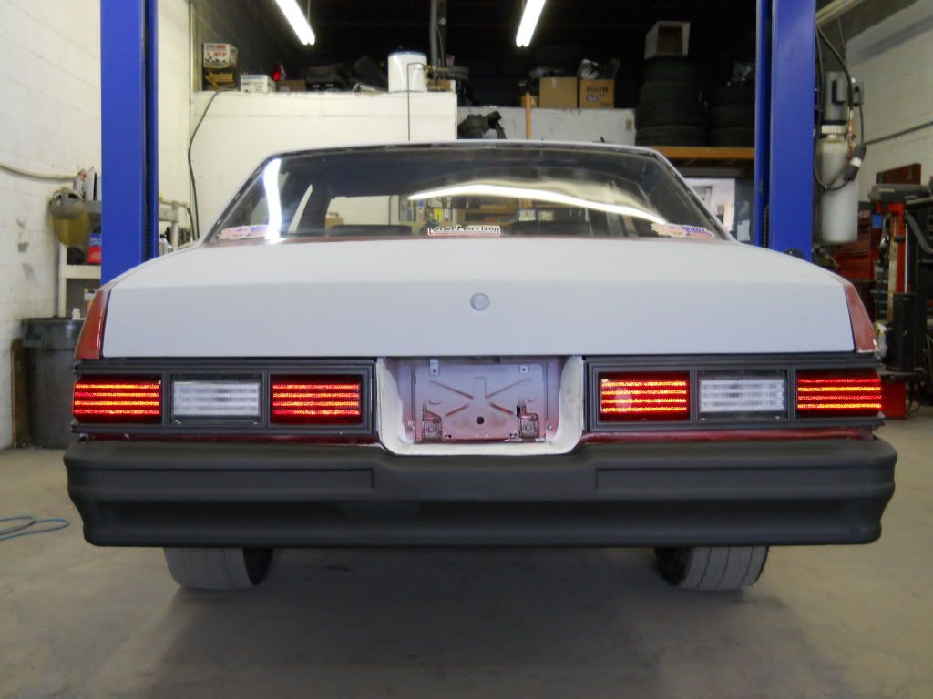

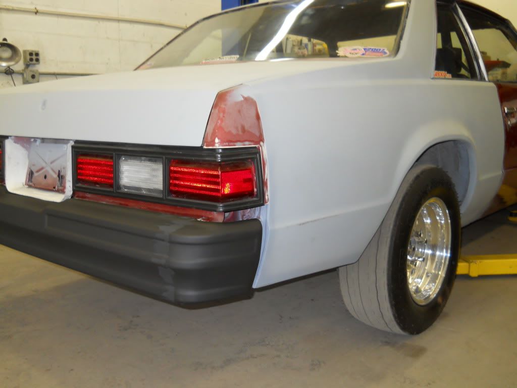

We still have tons of body work to do on the doors and the front end. Its getting done slowly but surely.
CLICK HERE ^

Do you you have some pictures of the full front and rear of your car?? I would really like to get a better idea of how mine would turn out. You said you only took out 1 1/8th of material. How far in did you go and the support behind the bumper how did you get it to line up to the mounting holes?

Due to the age of these cars and metal fatigue over the years, I wouldn't go by other peoples measurements. I took a different amount out of each side to get both the same. Best way to do it is mount the bumper on the car, measure how much you want to take out from each side. then cut.
as per the mounting holes, if you start your cut right where the corner is (where it first straightens out), you dont go into the mounting holes at all. Also, just a FYI when you narrow the front bumper, you will have to set the bumper back at least a 1/2 inch to get the sides back where they belong. due to the 'v' shape of the front bumper, when you take 1-2 inches out of the bumper the sides move forward about a 1/2 inch.

Yep, exactly what Betcha618 said. Hate to highjack his thread cause he's doing it the right way. Did all my measurements with the full bumpers on. Did my cuts on a band saw though. As far as pushing mine in the 1/2", I ordered (from TNT) shorter mounts to replace the standard length shocks and bolted the fronts right up. The rear mount plates were too far gone so I fabbed (minus the 1/2") new ones from mild steel, and used the stock shocks. The proper angle is built into these plates.
