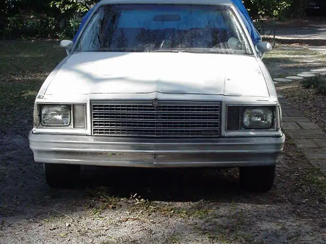

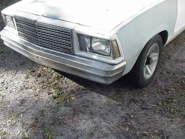

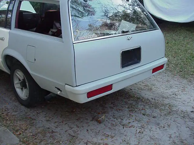

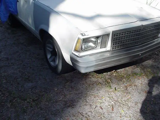

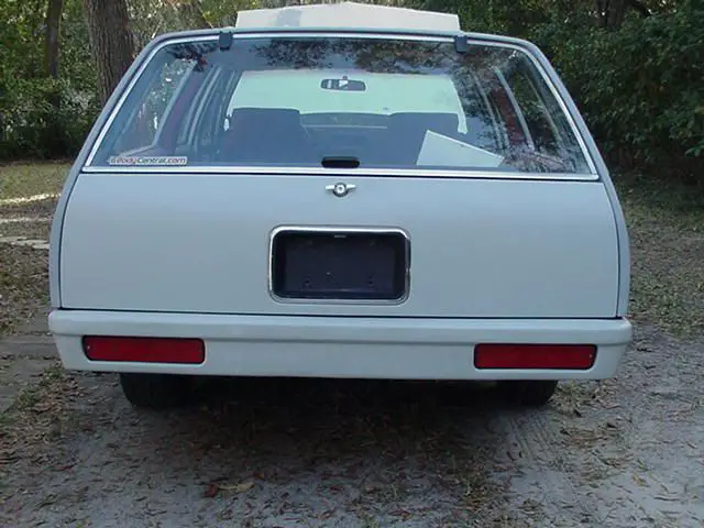

It's looks good, man. Have you also eliminated the fillers? I'd like to do mine in the near future. The front is pretty much the same, but the rear is a different animal, being a wagon.

no, keep the fillers and trim them to fit. without the fillers it looks like there is something missing.
Thanks for your suggestions. Did you have to trim the fillers in order to fit behind the bumpers?
I know what you mean about it appearing like something is missing without the fillers. Good point.
Betcha618
Sep 19, 2007
327
coram, NY
yea had to trim the same amount of the fillers i did off the bumpers pretty much, maybe a little less. trim a little bit at a time and keep test fitting because once you cut too much, you cant put it back.

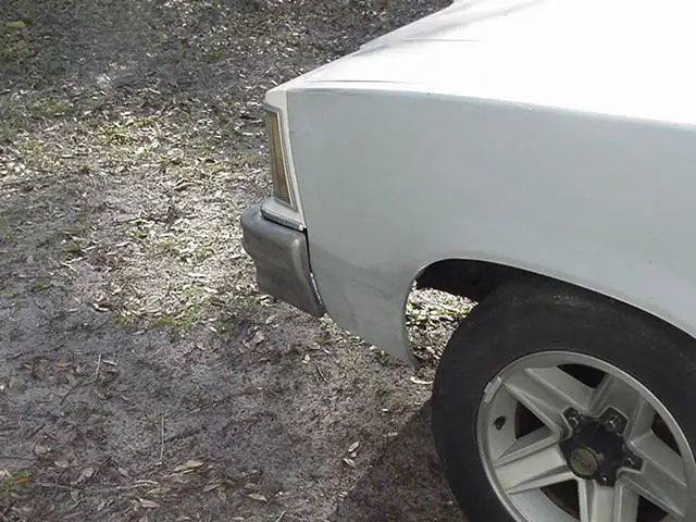

Wow......great job!! Looks as it should have been from the start. Looks like you didn't need the front fillers. Dosen't look like anythings missing at all. Nice fab job!! Chrome or paint?

As for the fillers. I just had it with them. It's been my plan for the past 7-8 yrs to narrow the bumpers and eliminate the fillers. I actually added metal to the bumper corners to add some contour where the fillers would have "filled in" or closed the gap. Also, I took out 1 1/4" from both sides.
