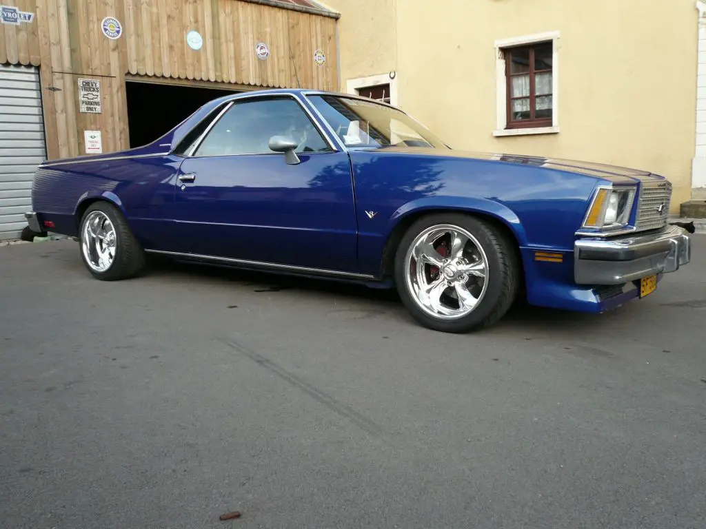

boyd coddington smoothie II
front 8x17" with 225/45zr17 backspace 4.5"
rear 10x17 with 255/40zr17 backspace 4.5"
2.5" front lowering and 2" rear

Whats the and model of those wheels and where can I get a set? :shock:
