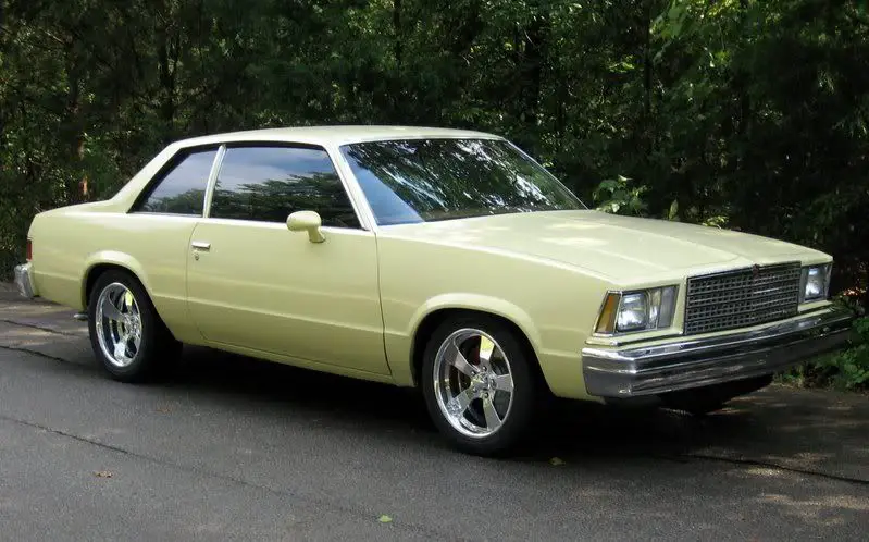

FRONT:
16x7 4.5bs AR Torque Thrust II
225/50/R16 Kumho Ecsta Supras

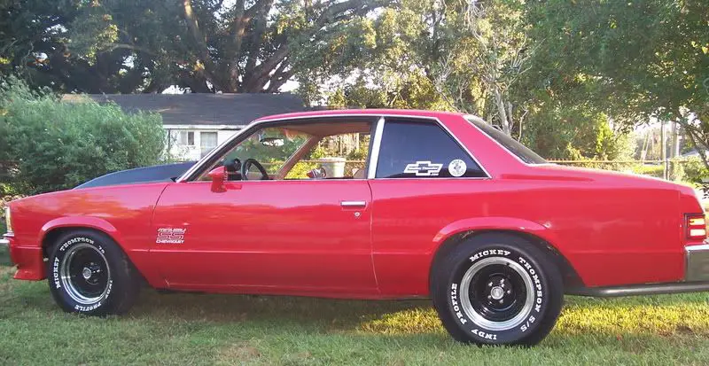

15x8 4.5bs Rallye Wheels
10x26 Mickey Thompsons

rolled fender lips, no other mods. Everything clears without rubbing, even with the usual offset rear.

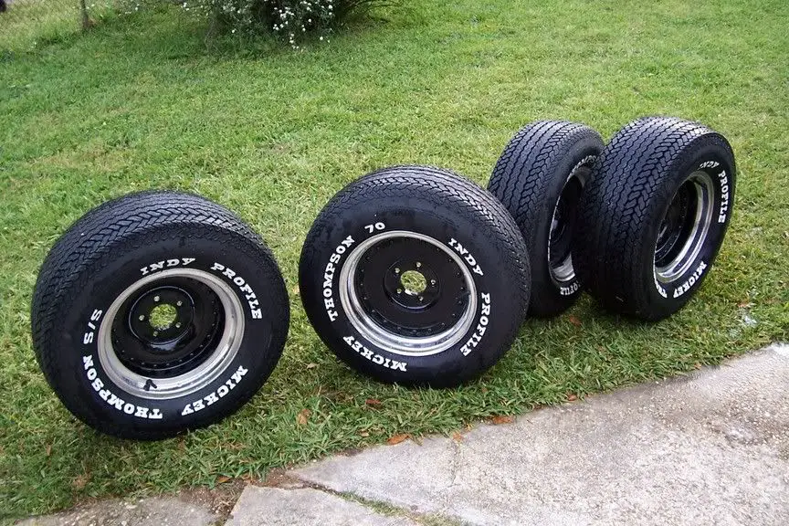

Well although Im in the market for some new wheels and drag tires, Ill post up my junk anyways.... :lol:
The wheels are some Autodrag knockoffs.
Fronts: 15x7, unsure of backspacing. M/T Indy Profile G70 tires
Rears: 15x8, 4 1/2" BS, M/T Indy Profile SS L60 tires
Front springs are cut and the car is lowering about 2-3". I actually cant use the G70 anymore cause of them rubbing.

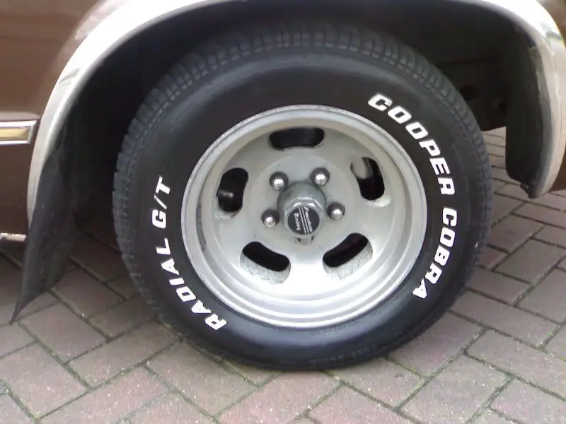

Mine standard wolfrace wheels
235 / 60 / 14 at the back and 225 / 60 / 14 in front :D
