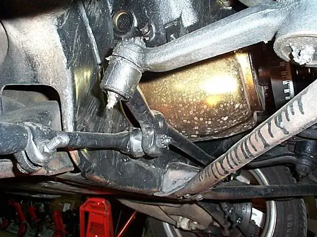

Bumpsteer is the change of toe during suspension travel. My first experience with bumpsteer in large dips in the road my car felt like it wanted to change lanes. I corrected it be lowering the inner tierod. I used my works alignment rack to minimalize toe change. The draglink is mild steel and welds easily. Marcus at SCandC has seen this pic, it gets him pretty wound up... :lol: :lol:

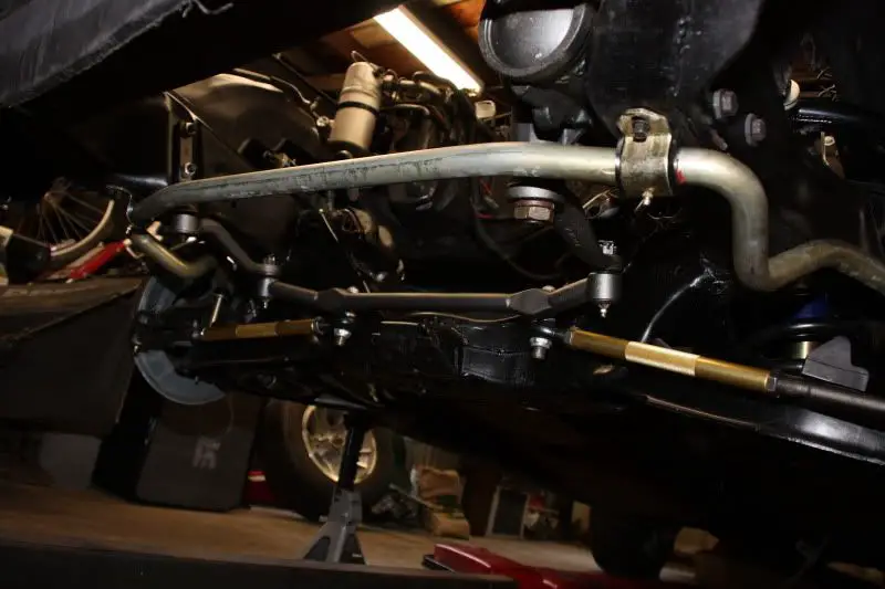

Here's my fix...

I won't say there isn't a change in bump steer, but it's nowhere near as big of a deal as people make it out to be. Sometimes I wonder if people complain about it just because once it's been pointed it out they start thinking it's worse than the stock suspension bump steer. I bet most never even noticed it before they changed the spindles because they didn't know what was really going on. I did the modified center link because I could, not because it was absolutely necessary. It was one of those "I wonder if I can improve this" kind of things. Don't let the minor bump steer change scare you away from an otherwise really decent upgrade.

No thread. I got it from someone else. Other than the fact that my setup allows the bump steer to be adjustable, I actually like dwkohout's mod better as it keeps the tie rod ends horizontal. There's no binding anywhere in my setup, but having the ends in the stock alignment is nice.
