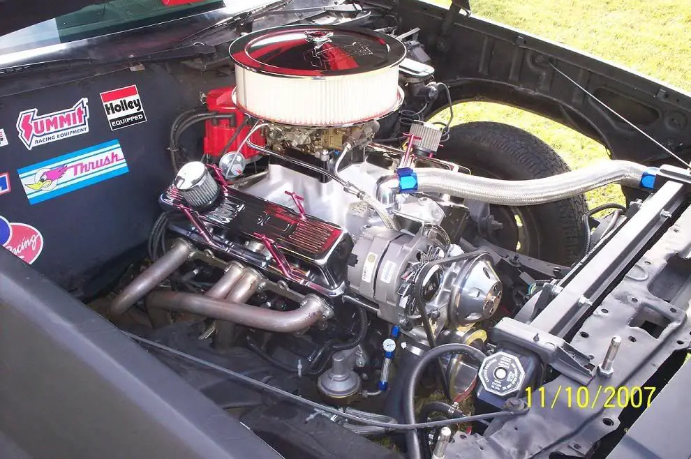

350ci in a 79 bu

lookin good! :thumbsup:

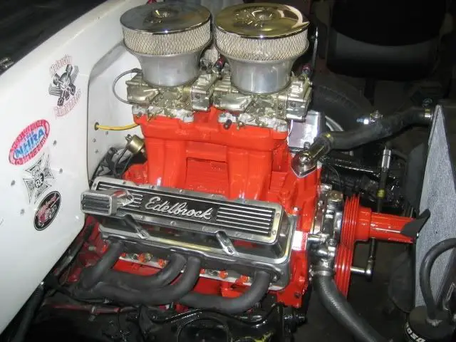

WIKD 81 said:
Heres my 406, a little dirty from sitting but you get the idea ;)
Ralph
now you know when you see a 4500 on a smallblock, there's some serious shizznit hidin' inside that little mouse. groovy! :thumbsup:
Ralph
:roflback:
thats what i was thinkin. that really looks tough, cover it with an aircleaner and no one will know! bad### little motor!
Ralph
:roflback:
Thanks guys ,I'm hoping it will get the job done when the car is ready :D
Ralph.

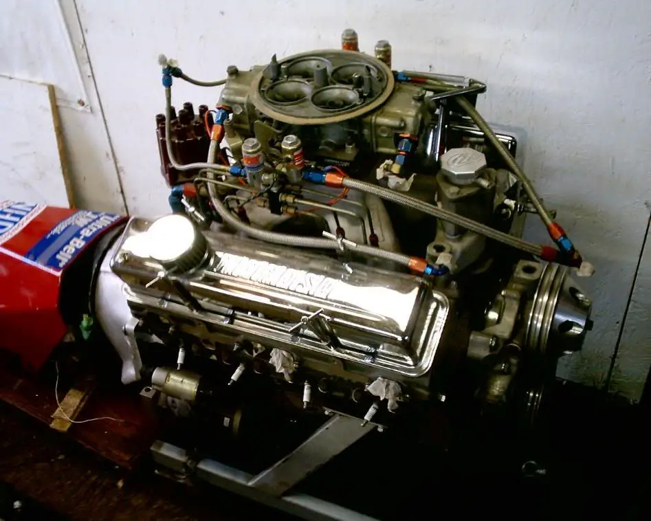

here's my buddy andy's fresh 331, just before 1st fire-up. it's got a stock steel l/j crank, rebuilt stock rods w/arp's, stock replacement forged fuelie vette pistons(10.75:1), ported edelbrock rpm heads, crane solid roller(.600 lift, 256/260 duration @ .050), edelbrock street ram tunnel ram w/600 cfm holley 4160s. it's too small to make any real earth-shattering power, but it should be good for 450 or so, and it'll wind to 7,500 rpm to get there! it's gonna be a fun little screamer. this is his temporary motor, just so he can drive the car for the summer & concentrate on the interior and getting the blower motor ressurected(maybe replacing the 6-71 with 2 turbos).
