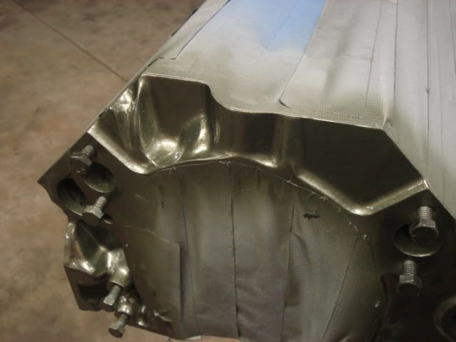

I used grinding stones on a side angle air tool, to get the rough casting off and than went to 2" sanding disc's on the same side angle air tool and then stepped up to a regular grinder with a disc that you can get at any lowes etc its made to rip paint off metal its more a sanding disc than cutting disc really takes it down nice i have used it on the body in places aswell really cleans up metal quite nicely.

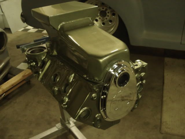

Shot the motor and pan today nice to finally see the Body Color up close and personal. Off to the machine shop now to install the bottom end!

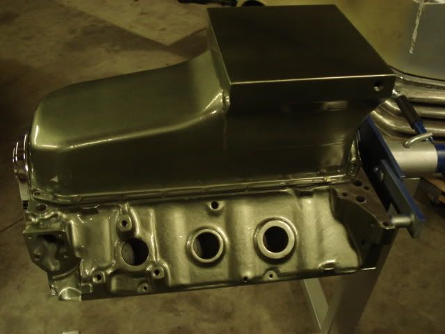

Thanks guys really appreciate the comments!
It will look Way better stuffed full of Mahle pistons here soon and a solid roller Voodoo. Heres a few other photos of the motor. It always seems like alot of work but from building a few other builds in the past ive learned that id rather take the extra time with no rush date or anything to make it exactly how i want it i built my nova and smooth it up aswell including the frame etc. and you alwasy wish you would of done something a lil differantly so trying to stay at it and enjoy the build!
