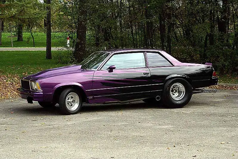

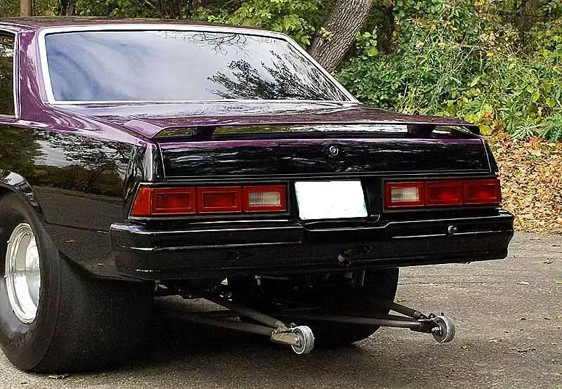

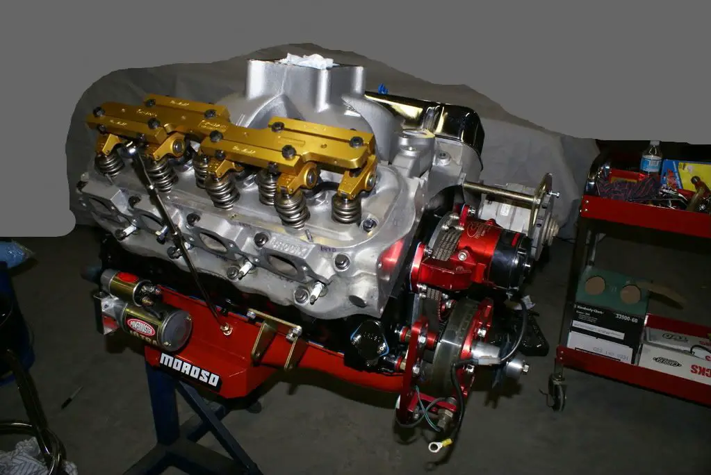

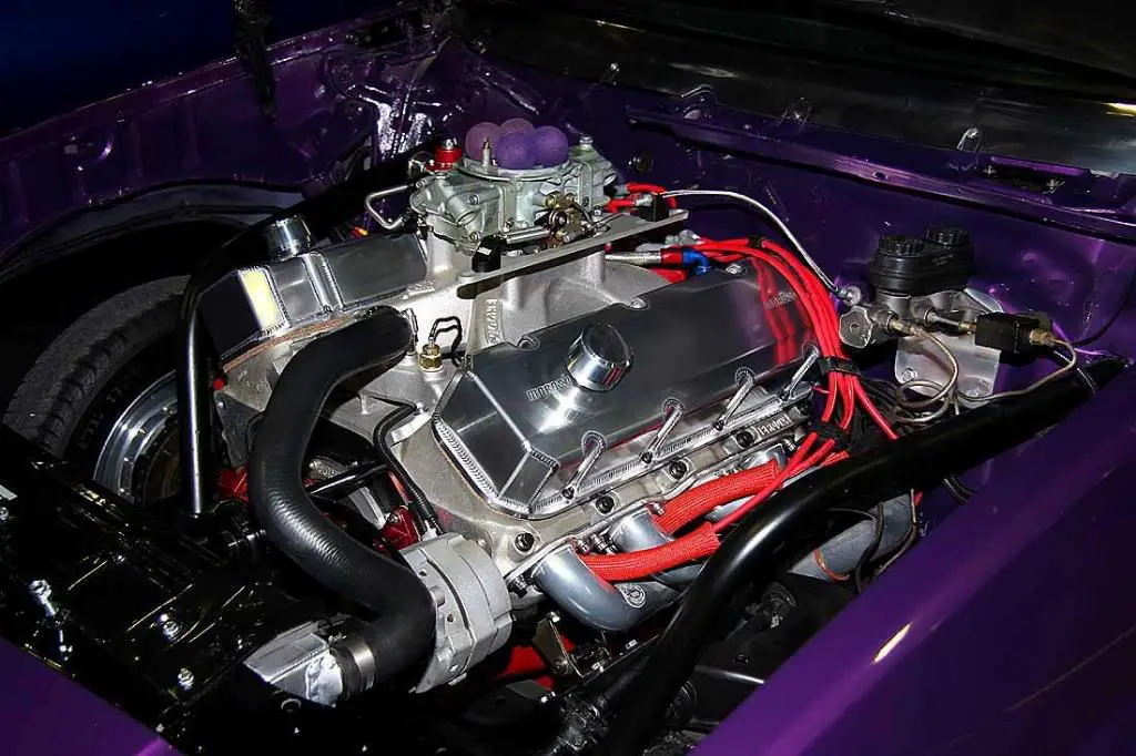

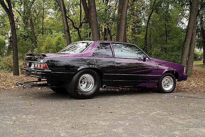

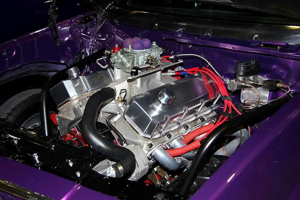

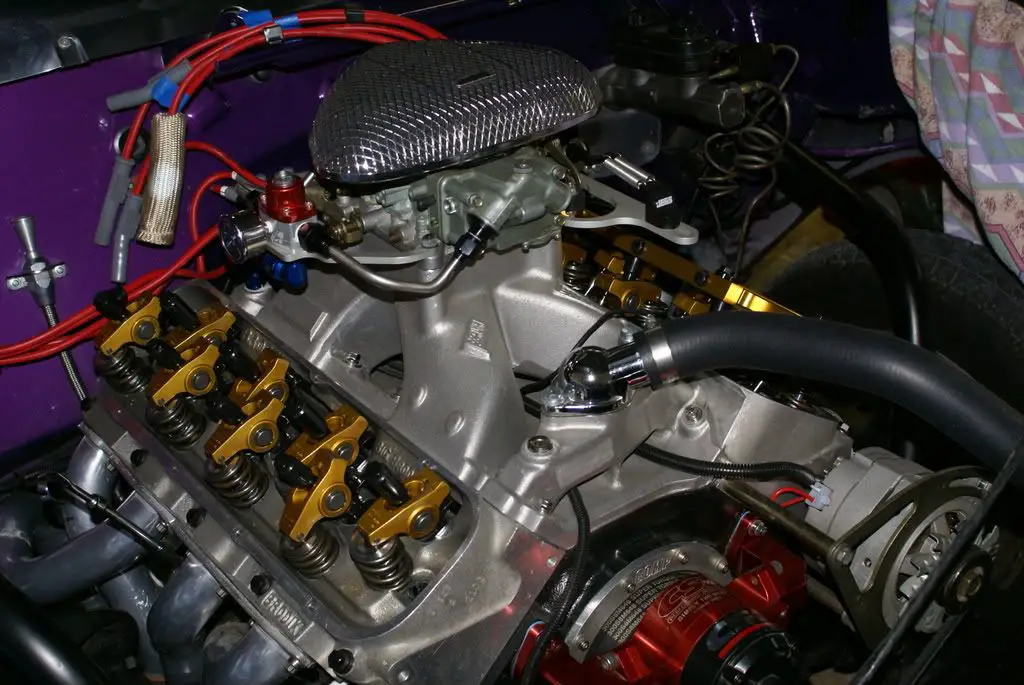

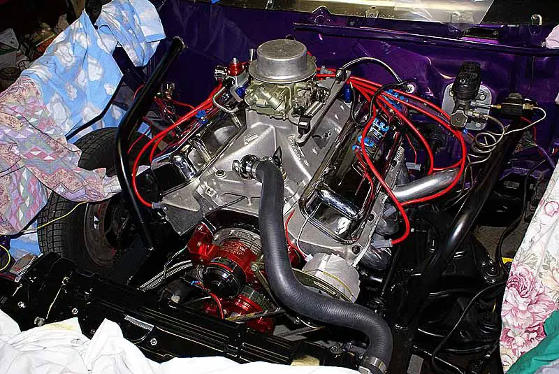

here's my little baby
496 stroker, JE 13.2:1 pistons, Eagle h beam rods, Eagle 4340 crank, Brodix heads and intake,solid roller cam and lifters, all arp bolts,reworked 950cfm carb, all msd ignition,crank trigger, comp timing belt,Hooker super comp headers.

Showman I love it great looking ,but watch that foam in that bug eye one back fire and it lights like a candle.Been there done that.

I'm not crazy about that air cleaner but it is the only one that is low enough to fit under that hood
I'm fighting clearence issues ... with the solid motor mounts and the tall intake
bought the car as a roller
the hood was a 6 inch cowl and someone cut it down and said it was a 4 inch was primer
got it painted dropped the engine in and put the hood on and found it was alittle tight
measured the cowl and found out it was a 3 inch
found out don't take peoples word .... measue it before painting
will get a 4 inch one day
wanted this one look at the 2nd one the wedge

showman, nicely done, that thing tubbed?

Great looking ride Showman. I agree with the guys on the air cleaner...
Just put one of them fancy covers over it at the shows and run without one otherwise.

DON'T WANT TO GO TO A 6 INCH HOOD
HAVE 3 INCH NOW WANT TO GO TO 4 INCH
BUT I THINK THE POLICE WOULD NEVER LET ME DRIVE WITH A 6 INCH HERE
THEY EVEN CLAMP DOWN ON THE BLOWER GUYS
FOR HAVING THE VISION OBSTRUCTED
TOO SCARED TO RUN WITH NO AIR CLEANER DON'T WANT TO SUCK DUST INTO THE MOTOR
WHEN I DRIVE
