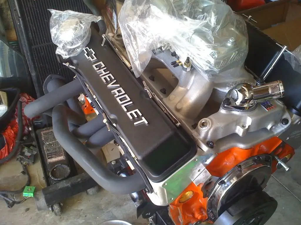

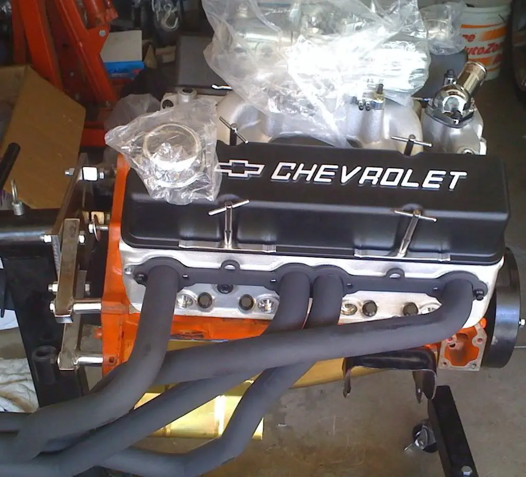

Put the bottom-end together for the not-so-cheap Malibu project...
0.060 over 454 with L-2465F 'L-S6' pistons. Truck rods with ARP Wave-lock bolts. Two bolt block with a cast crank. Got an Elgin E-1070 hydraulic flat tapper cam .528/.552 lift 224/234 @ 0.050 duration with a 114* lobe center. Moly rings (top one anyway). Melling oil pump with cheap pick up and 8 inch deep pan.
Now, depending on the machine shop, it will either get some -781 heads with 2.19/1.88 valves and mild bowl blending or a set of -088 square ports (gotta' love boat guys when they upgrade)...see which ones get done first....
Then it will be Vic Jr (square) or RPM Air Gap (oval) because I have them in the collection. Supposed to go look at an oval RPM intake on craiglist tomorrow...would like an RPM Air Gap or RPM square port.
I have a couple of small stall's so...
Maybe it will be pretty peppy!

IMO, the Vic Jr. won't make for a really happy combo with that mild cam. I'd go with your second plan of using a dual plane, regardless of which heads you choose.
