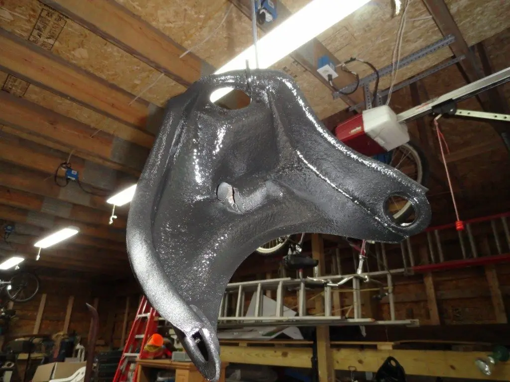

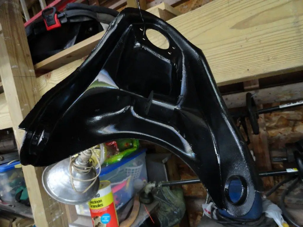

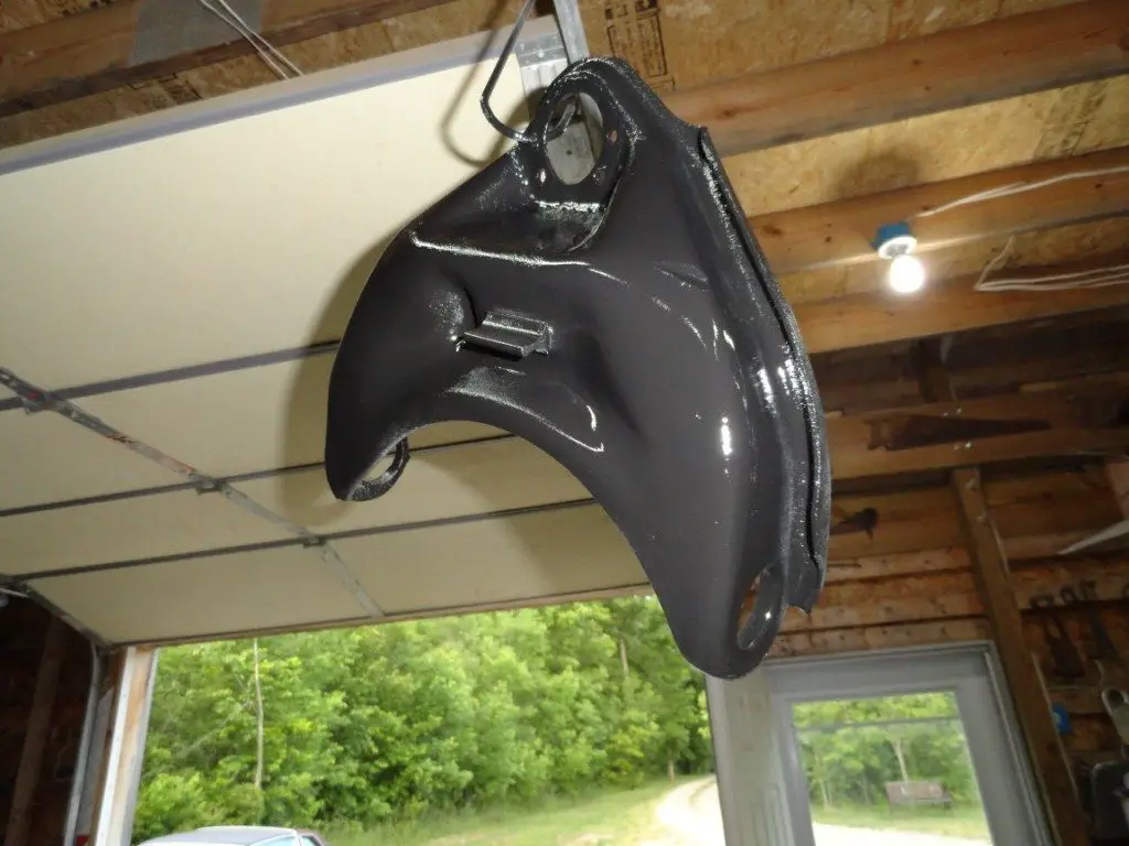

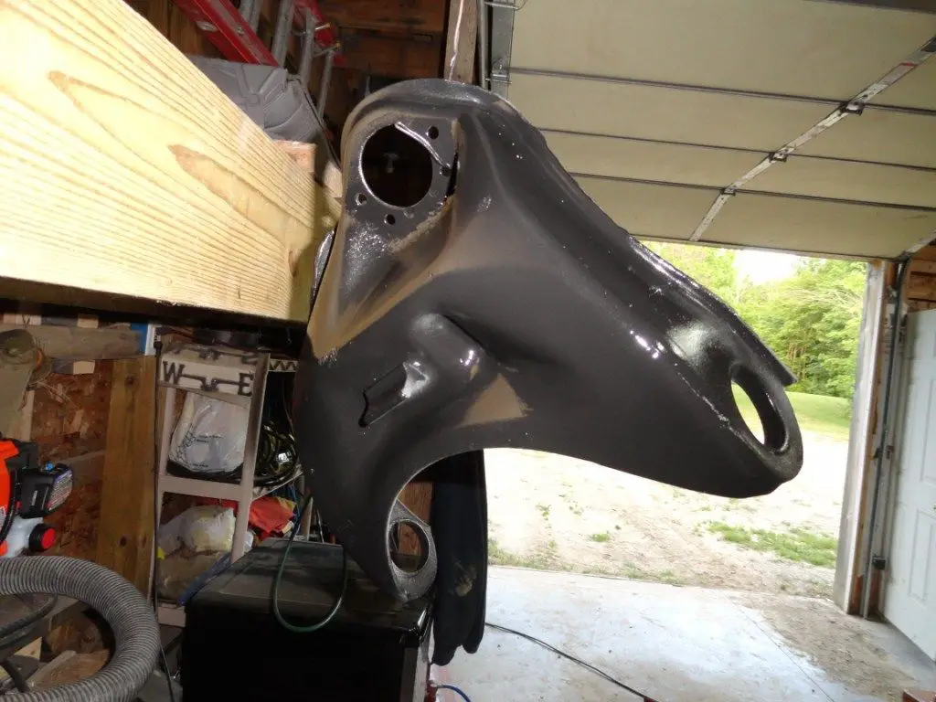

I was sleepy last night so I didn't get pictures up of what I did...

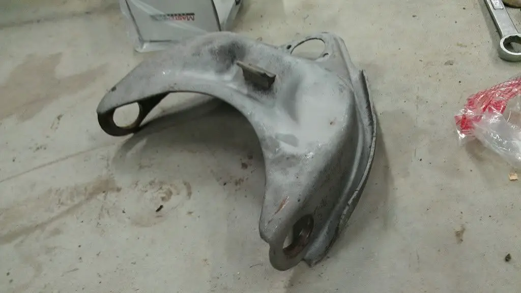

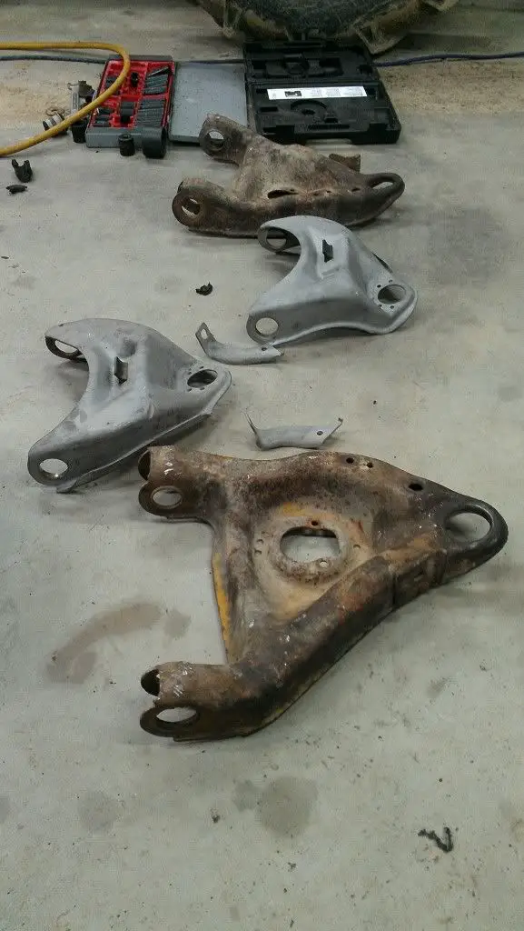

Today I plan on cleaning/painting the blasted arms, maybe putting the bushings/ball joints in, and I'm also making a run to O'Reillys for another set of control arm bushings I ordered.

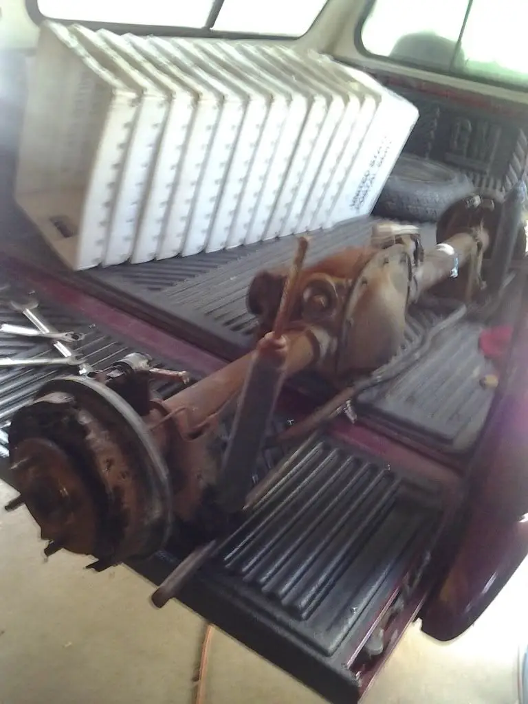

Bought it an 8.8 out of a mustang......now the fun starts.

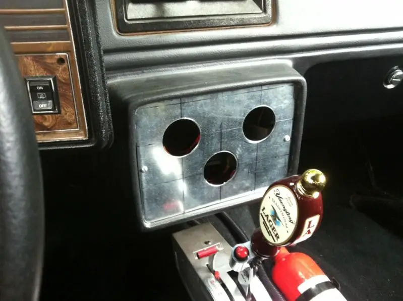

made a new plate to move my gauges from the a-pillar to where the radio goes. waiting for the angle rings to come in to complete it.

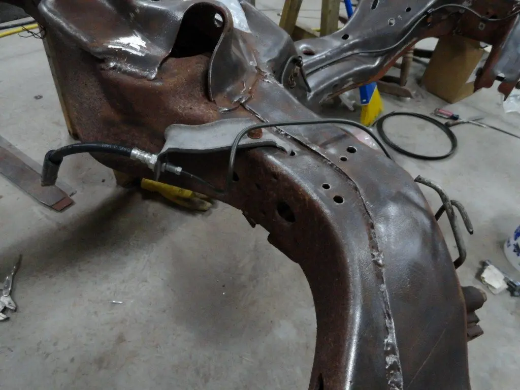

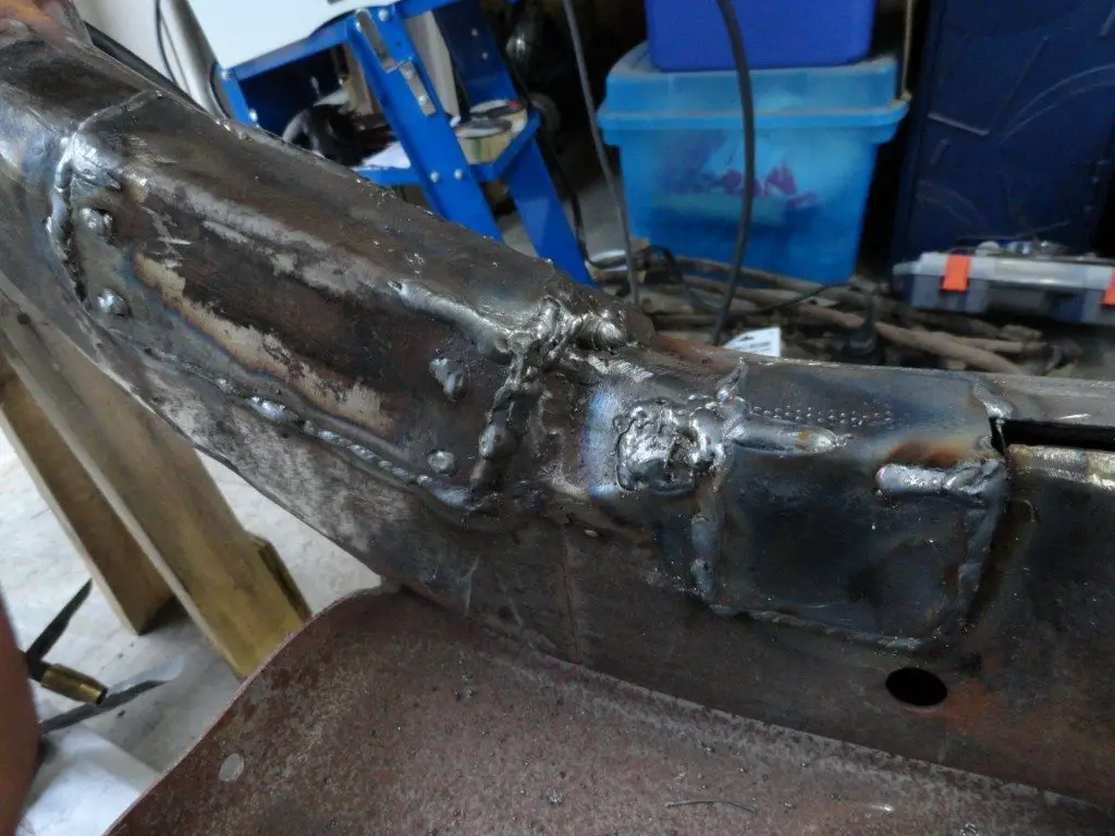

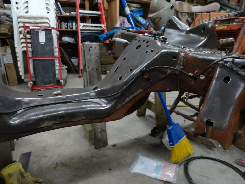

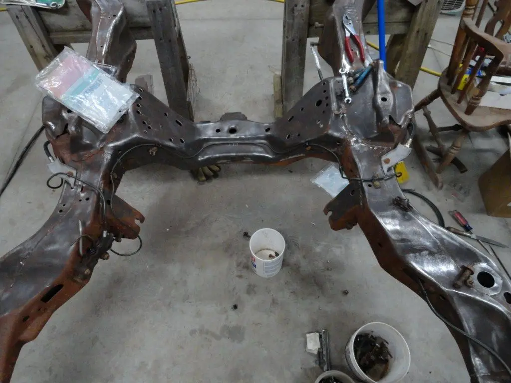

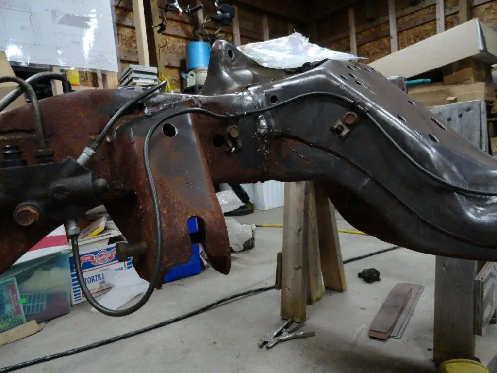

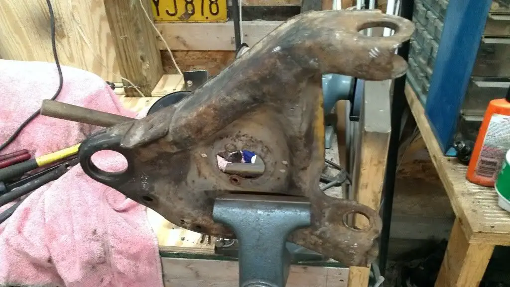

I welded some 1/8" plate in to reinforce the triangular braces at the rear crossmember, and rewelded a couple of the lower trailing arm mounts (some had hardly anything at all). I also welded some plate on the outside of the flat upper arm points, they're getting pretty crappy... I'll have pics tomorrow. The frame needs a wipedown then it's ready for paint \:D/
yea some bad/lack there of welds on these frames huh?sounds good doob
