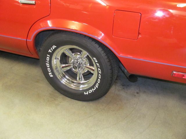

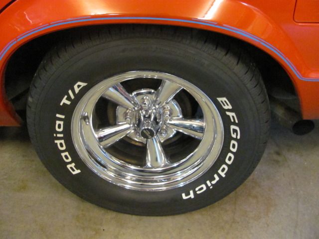

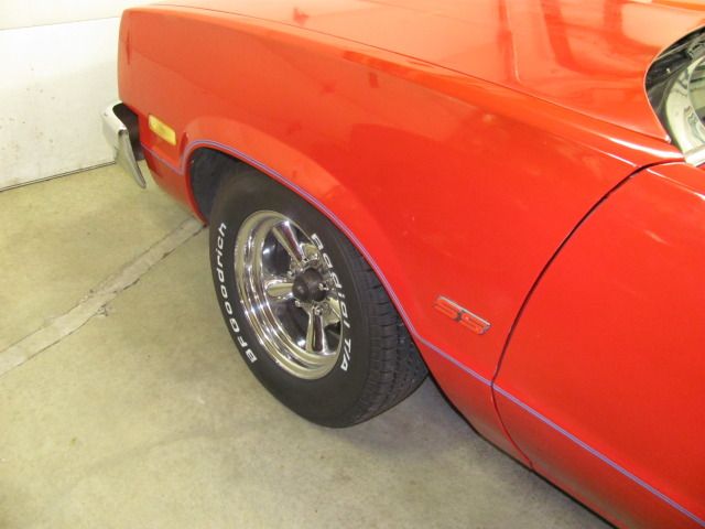

Finally settled on a wheel/tire package.
Old school Supreme Wheels. 14x6 fronts with 205/70/14's and 15x7 rears with 255/60/15 BFG Radial TA tires.
