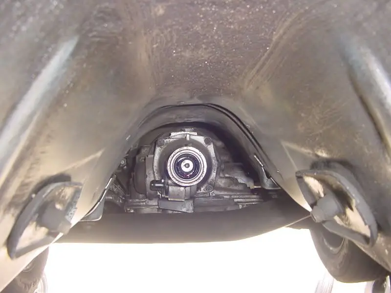

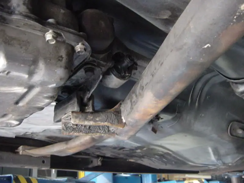

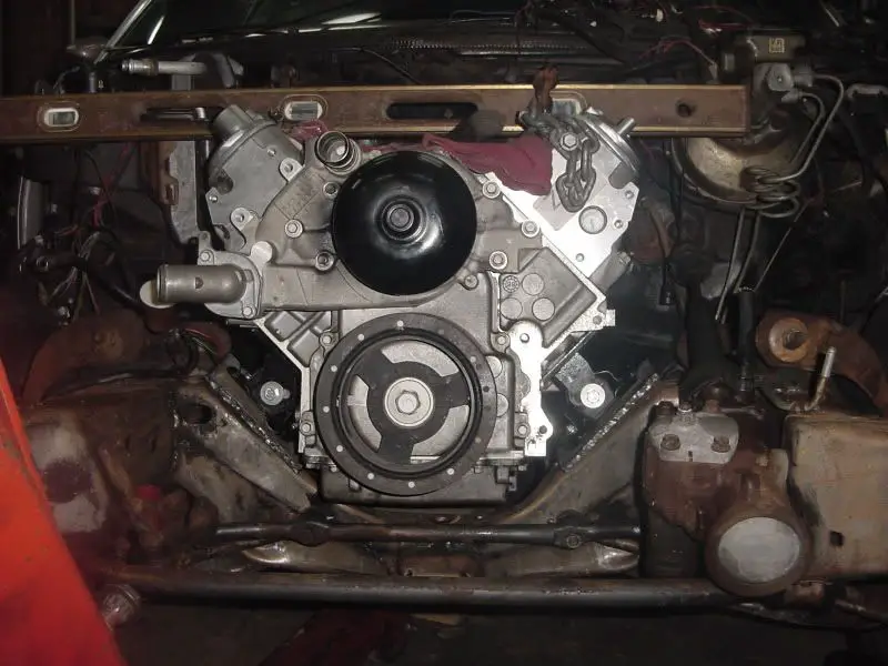

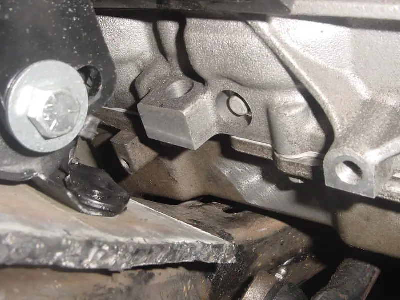

Got the trans bolted in yesterday. Went as smoother than I could have imagined.

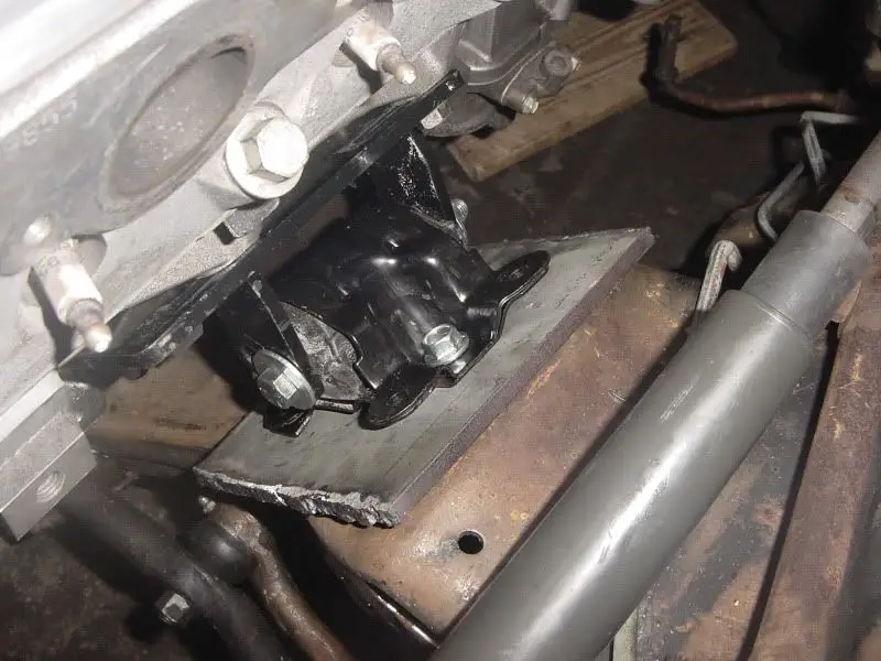

When I said center, I meant left to right. But I believe it is more important to have the trans point to the rear-end. Correct? Also, since the last update, I made 3/8" plates to put the motor mounts on. They are rough at the moment, but I cut them too big in purpose in case I found a reason to keep them that large. One thing that I did not snap a photo of though was the driveshaft. I have 2 of them. One from a late model silverado(Giant aluminum) and the stock one. Both are about an inch or so too long, so I gotta cut and weld. Which One should I use?

for a drive shaft, I took mine to a machine shop, but it was the stock one from a Grand national, had them put on the bigger joint for the transmission but I'm running a 4L80, so if your running a 200r4 or whatnot, a stock one should be fine. Eventually I've got to upgrade to an aluminum one, but don't want one of them big 4" ones from a truck...seems a bit too overkill for my application.
Looks good and is coming along great, you'll be very happy when its done...trust me! Just make sure you get the obdII port put into the car. anymore questions ask away or pm me

What adapter plate? It bolted right up. Am I going to have a problem with the converter and flywheel in?
