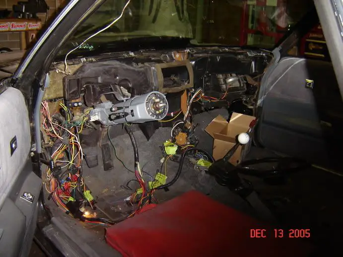

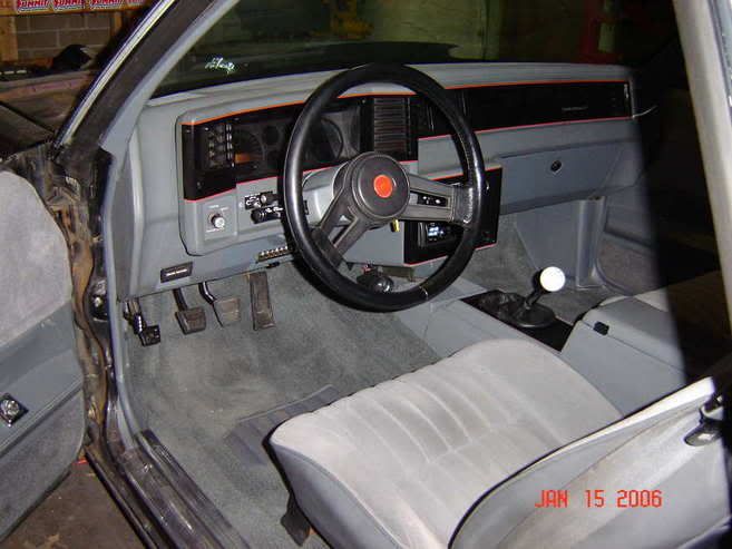

You can see the difference in shifter location between the Keisler kit and the generic swap TKO in these pics.

can you tell me how you got your clutch pedal to be the same hieght/location as your brake pedal? My clutch pedal sticks out WAY TOO FAR. I want a nice clean look and not huge pedal travel. As it stands now my pedal travel is just plain insane. And if I adjust the linkage then the neutral safety is constantly on.
The carpet came today and this weekend I will begin the the interior and complete that. I also had to get a new crossover u-joint. I needed 1330 to 3R. Need to modify the power steering bracket because the headers now interfere. I am close to finishing. I have decided I have waited this long... now is the time to take the CORRECT steps and not blow something up. Nice and easy.
