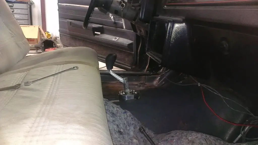

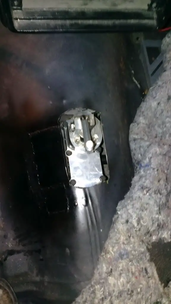

Here's the final shifter position.
This shifter is actually on backwards from how a t-5 would be, the TKO has provisions for both positions. I could have flipped it to the normal position, and rotated the shifter handle to bend forward but that was real close to the seat.
For the people that said you cant run a bench seat with a 4 speed. I did it just fine.
For the people that said you cant run a bench seat with a 5 speed, I'm about to do it. With actually more room.

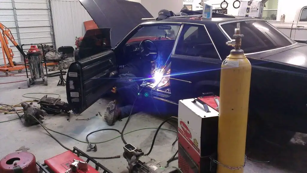

You can see the various patch pieces.
Welding up that 4 speed hole

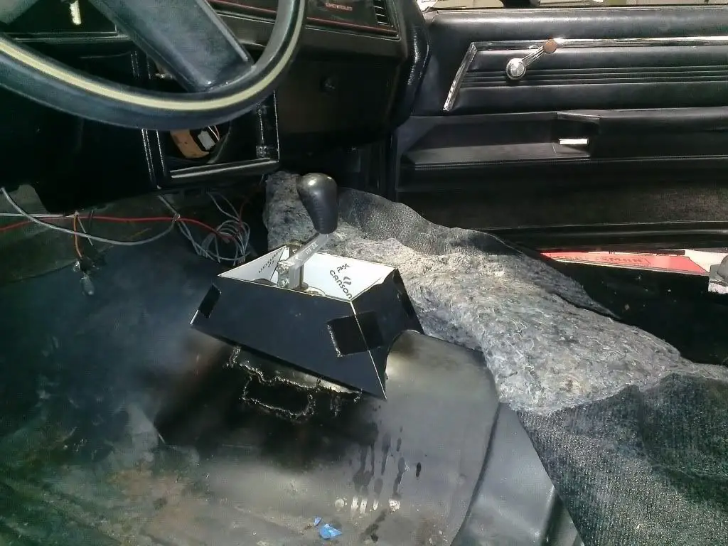

Here's a little cardboard job. I figure I'll measure for the top once I get the metal version sides tacked together.
I like this black trim ring from lokar. Apparently it doesnt come with a boot. I may buy the recommended lokar boot and just trim it to be short as ****.
The piece in the rear is pretty close to the angle of the front of the bench seat. I need to pull the shifter and put a hole in the carpet. I just slapped the shifter on to drive it. I was just too excited. Sure is different from a 4 speed. 12" shifts VS 4 inches. Shifting into fifth is a bit notchy but every other gear is just fine. Shifter is a Steeda Tri-Ax

That Lokar boot looks like the one that came stock in a Monza.
Are you able to make the box shorter, then put a sheet metal plate on top with a small hole and use a smaller boot and trim ring? (just my opinion, and more like they way GM did it with the T50 Cutlass)
I had a shifter about that short in my wagon and hated it quickly; it was too far to reach. I had to put a longer one. How is the reach on your short shifter?
