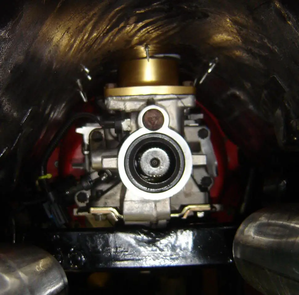

MeatDrapes - I noticed before that your trans has been cut behind the transmount. I am currently in the process of cutting my trans in the same area so that the crossmember has room to pass beneath the tailshaft. As the trans comes from Tremec there is a huge rib running from front to back with two beefy mount type holes (?) going from side to side. I think this is why Todd (El Coolmino) added 5" of plate to his crossmember. I also think his sits more straight from side to side than our factory ones, which sit on more of an angle - but thats just a guess. Could you please post a pic from the drivers side of your trans, similar to the one you posted before showing your tab on the crossmember? Oddly enough I didn't have a second of doubt about taking a sawzall to a trans that retails near $1800 !!

Hey, you're right. I never noticed either. Keisler must do that to allow the crossmember to run underneath.
That's a better solution than my crossmember tab. After paying that much, cutting it never entered my mind. Now that I think of it, that's highly unlike me :lol: . Already had the 2004r crossmember in the car, and was too lazy to slide it forward and redrill all the holes. End result- that long ugly tab
But I tell you, re-boxing the crossmember was no fun either. And I'm not particularly happy with the strength of the crossmember. But it's not flexing where I cut it, it flexes over the exhaust pipes. Once I get some other stuff sorted out, may end up with bolt-in braces under the exhaust to box the C channel, or I may ignore it until the end of time.
If you look close, you can see that aluminum rib shooting down into the cutout I had to make in the crossmember. My transmission mount looks taller than yours too. It's a std energy suspension ford mount.

My Tremec came as you see it. I did not make any cuts whatsover. The rib must have been milled off. Today I had a gusset welded onto the crossmember because the tailshaft has been hitting when I went over bumps. I will take some pics and post a whole bunch this weekend.

Alright. I have a picture of the new bracket I had welded on. I dont think its going to do very much..maybe a little.
The next pic is the clearance of the rib thats been milled off in relation to the top of the crossmember. Keisler removes the rib and a bracket for a torque-arm that is not used in the G-body. I didnt even know anything was there to begin with.
The next pic is my problem. There is nothing left of the slip yoke. Its burried inside the transmission. I need to shorten the driveshaft by 1/2 - 3/4 inch. Keisler will do it, but it would take weeks.
Next is the driver side on the crossmember.
