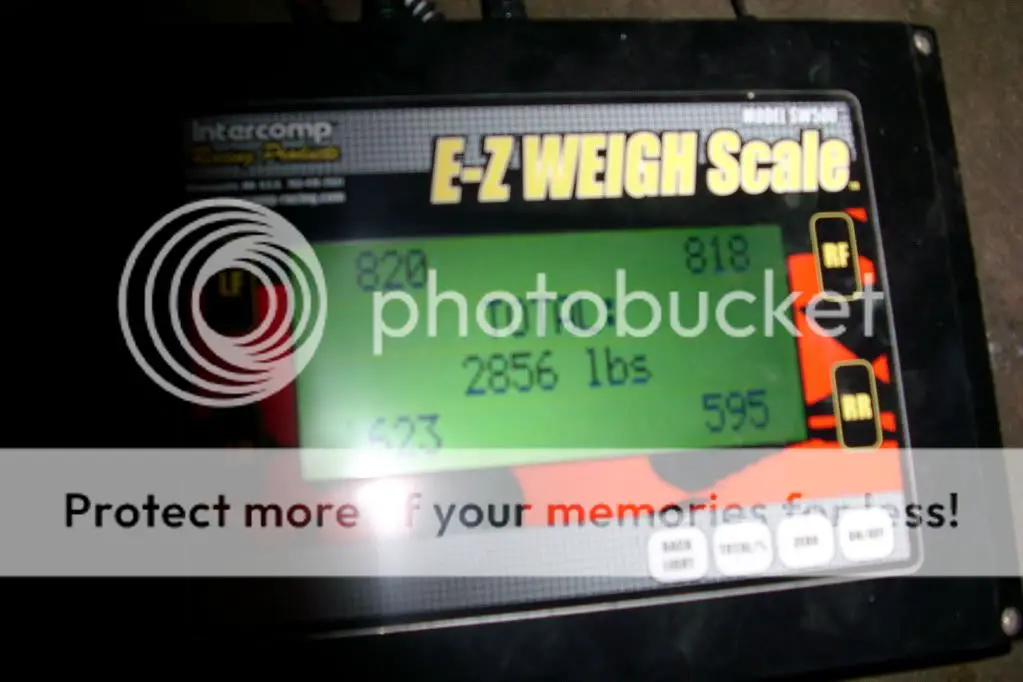

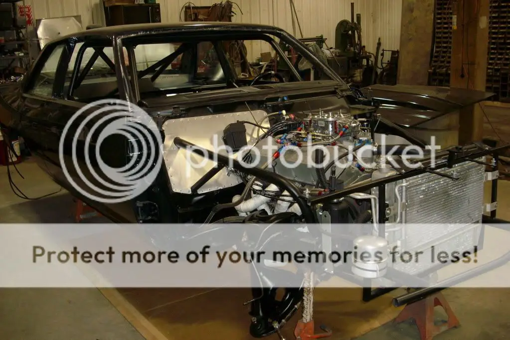

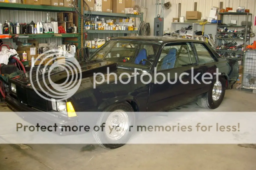

rollcagerage said:Heres how mine turned out, steel bumpers and stock a-arms and a bbc.
Well, Its a long story but heres a start, http://www.maliburacing.com/forum/viewtopic.php?f=2&t=90388&hilit=door+diet This covers alot of it, basicly just put as much .035 aluminum in it as posible along with tubular frame rails, a powerglide trans really cuts down the weight also along with aerospace brakes and cutting off unneeded frame parts. There is more weight savings yet I could do like lexon windows, glass bumpers, glass trunk lid( I did cutout the inter structure out of the steel trunk) tube upper and lower control arms I'm sure theres another hundred pounds if I did all that. As far as a driver I had my wife sitting in it with a old bench vice in her lap to = close to my weight so I could get the pic. and adjust the suspension.mike from bc said:rollcagerage said:Heres how mine turned out, steel bumpers and stock a-arms and a bbc.
what all is done to get it that light ?? and is that without driver ??
